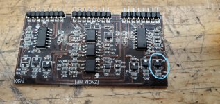

It’s a 1304 but if you have problems sourcing that transistor you can use a
2SC3326 .
I’ve used the 3326’s and they worked just fine in several amps
