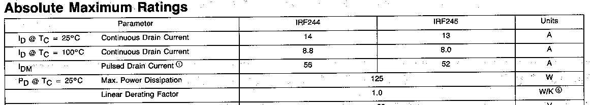

(89-25)/4 = 16
12 × 16 = 192W
Zen Mod was being a funny man. 42 is the answer to life, the universe, and everything.
I was almost able to understand Zen Mod's joke 😎
But in the example (below) there is a difference between:
TJ=16 * (1 + 1 + 2) +25
and TJ = 116
16 * 4 + 25 = 89
But Tj is 116
116 - 89 = 27
And now i can't sleep, what is this 27 and where did it come from?
In our Aleph 2 example
Tj = 16 * (1 + 1 + 2) -25
Tj = 116 deg C.
And this is why Aleph 2's don't break.
