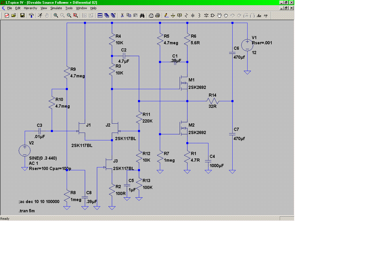

Nigel, i seldom use long tail pairs. My speciality is low noise, high speed anyway so i more or less focus on phonostages and linestages, also buffers and active crossovers.
Well, that is not 100% true. I just designed an MC input i called Abraxas. That is a parallel-symmetric-differential design so it uses complimentary long tail pairs with a twist.
My typical design is parallel symmetric, currentmirrors, transimpedance RIAA, buffer.
BJt and JFet have both their advantages. BJTs are lower noise in the bass because they have a lower 1/f frequency then J-Fets. They need only 1/10th the idle then J-Fets for the same nV/qHz spec. Problem can be how to generate the bias. It should not add aditional noise and it it difficult to DC couple ( in a parralel symmetric design, no problem with double diffential but with a 3dB noise disadvantage becaue the trannies in the long tail pair are in series with the noise ).
The base current is an error source but i found ways to " recycle" it.
J-Fets on the other hand are self conducting and high impedance at the input so bias and DC coupling is a breeze. They also "sound" a bit warmer and fuller then BJts but PRAT factor has to be watched or they sound less dynamic. They also have less problems with radio ingress. BJTs can have that proble because you could see the base-emitter diode as a detector....
