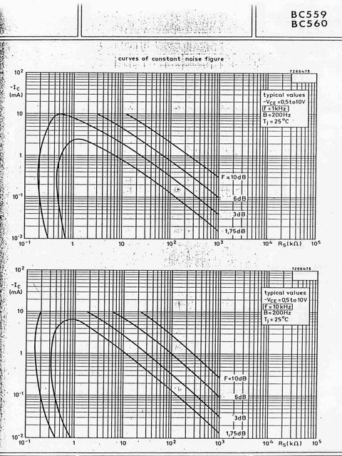

It's a little more complicated than that. Let's look at those excellent for MC transistors produced by Rohm - the 2SB737 and 2SD786 - we loved them , made heaps of MC front ends out of them , always biassed at 2+mA! for low noise with low source impedances! Then there's the electret condenser microphone preamp having to deal with sources of Mohms not tens of Ohms. Very different.
Horses for courses.

before anything else
it is also customary to know which topology are you refering
for.....
because talking about noises it varies with amplifier topologies used...
for better noise rejections used the MIRROR IMAGE topology.
rgrds,
macweb
To do you an idea of the distribution of the noise in the bjts...
