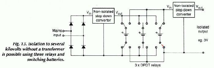

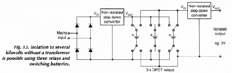

One of the ways to make a transformerless power supply from the standard, mains, hot and neutral voltage is to convert this AC voltage to a DC with a bridge, scale down the DC and use a standard, switched flying capacitor, charge pump inverter, such as LTC7820 and the magnificent TDK Lambda converters
I'm not sure exactly what circuit you have in mind here. Could you add a basic circuit to clarify please.

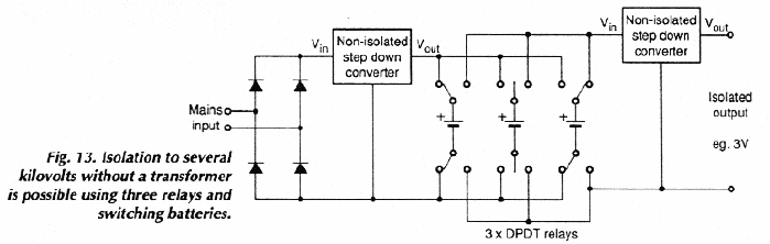

BTW An article on direct-off-the-mains supplies was published in Electronics World Sept 1997 and can be seen on MyDrive/My Articles "Switched-capacitor-power-supplies" and the patent referred to is also on MyDrive. One idea for isolation without a transformer to 3V:eek: for PC's was to use relays and flying batteries (below) but I have never seen this used commercially. For audio amps you don't need the second down converter on the isolated side.
attachment.php
If one of the relay contacts gets stuck and the other switches over someone can get killed.
Even if safety relays are used which prevent this by locking the contact pairs together, the contact clearance is below legal requirements.
Big contactors may provide the clearance, but they are LOUD.
Hi Holmer,
Isn't sticking of relays due to welding? But in my arrangement welding is prevented by using 3 relays, so when one is 'flying' it doesn't break voltage, so in principle no arcing or welding.
Clearance is then determined by air breakdown, which I think must be several kV for relays like the relays we use for speaker protection.
Since this is a non-standard application existing standards are probably not relevant. But as a lone designer wouldn't want to get special approvals at today's rates.

5. When rechargeable batteries are used, although the device which uses them is safe, the device which charges them from the mains is still not, for the said reasons.
6. Rechargeable batteries may be charged safely with sun and other alternative powers.
7. The only other safe way is to use non rechargeable batteries. They are expensive, but, they are charged by the manufacturer and not by the user and are safe to the user.
8. Batteries may leak, but, this is not an electrical issue.
9. Some batteries have acids, but, this is, also, not an electrical issue.
10. Batteries are unsafe too when their maximum voltage difference is higher than 60V.
Some low voltage generators may be OK as long as they do not generate more than 60V and or have a very low current ( power ) abilities.
Car plugs are safe. The voltage is huge, but, the resistance of the wires is huge too, so, the maximum current is tiny.
Car batteries are safe too. They can provide huge currents, but, only 12V. The same applies to the alternator. An alternator can output 10A but at a very low voltage, around 13.2V or slightly higher. A fully charged car battery is not 12V, but, 13.2V. Still safe.
I think this clarifies the points of safety. In summary : There are two types of safety : 1. Whatever a standard in a given country says is safety. 2. The real safety.
Again, back to the example : a tube amplifier or CRT TV power supply is considered safe by the standards of all countries, but, in reality, such a power supply is not only unsafe, but, extremely dangerous.
The same applies for audio amplifier supplies with more than 60V maximum voltage difference. Some solid state audio amplifiers have more than 60V voltage difference at and after the secondary. These are extremely unsafe regardless of what a standard or anyone says.
In case there are so many unsafe things, why are they allowed? Because there is no other choice. The standard was forced to allow CRT TV and audio amplifiers and still is. The standard knows they are unsafe, but, there is no other way. The standard wants safety, but, does not want to prohibit audio amplifiers. This is why the standard just looks the other way.
The same applies to stoves, power tools, Air Conditioners, electric heaters, etcetera. To allow these, the standard says : ground all metalic cases and metalic touchable parts, inputs and outputs and do not connect neutral to ground. Neutral is connected to ground somewhere in a household by the electric or construction companies with a thick wires and connectors and, in some cases, this connection is not provided to the user ( hidden somewhere ). Most apartment buildings have their own transformers, provided either by electric or construction companies.
I think this answers your point.
Your circuit is lethal, under Australian electrical regulatory standards this type of power supply wouldn't be permissible.
I don't understand how there are stickies in the Tubes/Valves forum warning of the lethality and dangers of high voltages but there none such here in the power supply forum.
You posted this while I was typing. I answered this in the previous post.
Again, as mentioned, every VOLTAGE power supply with a maximum voltage difference of 60V is dangerous. This applies to transistor amplifiers too.
Every power supply with a possible voltage difference, higher than 60V, must be heavily current limited. The example of this is the car plugs which generate KV, but, the resistance of the wires as well as the internal output impedance of the coils, etcetera are very high, so, only a very tiny current can go through a mechanic.
The power supply suggested ideas, after the mistakes corrections, is very similar to a stove. Stoves are supplied by 240VAC : 120V, center tap, 120V. 50A max. They do not have transformers. The case is metalic and grounded. Neutral does not touch Ground. Stoves are considered safe to be used by children at and after 12 years of age. Laundry machines and driers too.
There are very many metalic power tools, supplied the same way. Heaters, Air Conditioners too.
The Australian standard is just as unsafe as anyone else. However, I am sure the Australian standard allows devices without a transformer. People cannot without these.
As clearly explained, the idea is for a completely closed system with no electrical input and outputs.
How can a power supply have no input or output?
Your description of mains power distribution in the home is not applicable in other countries.
Your definition of electrical safety is certainly not supported by Australian electrical standards.
Within electrical standards there are definitions for what is allowed for in certain types of electrical installations.
Your lack of knowledge about these regulations is alarming.
The closed system is this :
Power Supply -> Amplifier -> Speakers. Input : Bluetooth. Gain and other controls : Bluetooth and infrared, non galvanic.
No galvanic inputs and outputs. No speaker outputs. Speakers, inside. No potentiometers. Nothing touchable.
OK. In case, you want to divide power supplies : What is the power supply of a high power solid state amplifier? Where does this power come from? From a transformer. What is the voltage and current of the transformer? High power. No difference then.
Alarming is the common misconception of transformers as being safe. They are just as unsafe as without them. Imagine 1 : 1 transformer. No difference.
The only difference is : with transformers Ground does not connect to Neutral ( nor to Hot ). This is the same in Australia nd everywhere.
You can spin this nonsense anyway you like, at the end of the day the circuit and the concept as is stands is not permitted under Australian electrical regulations.
I can only advise people to ignore your power supply design and only use power supplies that comply with electrical standards and are approved to be used in their respective countries.
