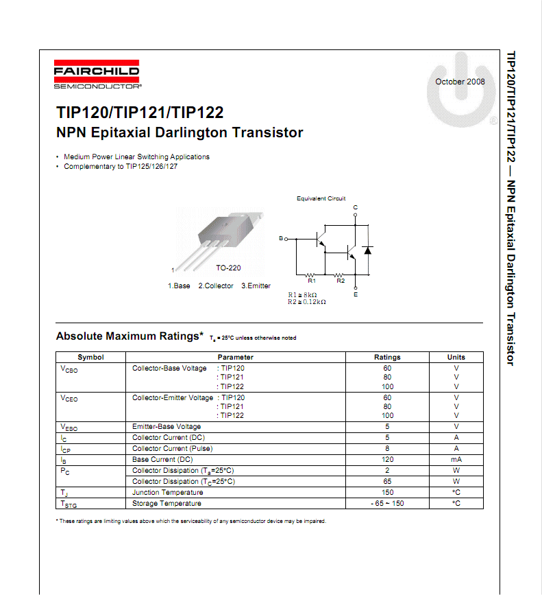

Thanks for the tip (bad pun, i know!). I will pick up a TIP120 at radio shack. this seems like this is the new schematic, a small transistor with max Ic=200mA, and the second transistor connected to the fan is the TIP120:
All you need is the base resistor. see below... tip120 has everything else inside.

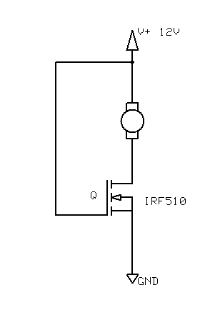

The 12V supply pin coming directly from the xbox's power supply is .2 or .4 volts when the xbox is turned off. When it is turned on, it is 12V.
If I connect the fan directly to that pin (or a point on the board that is connected to that pin), .4V will be going through the fan while the xbox is turned off.
I wanted to make this switch using a transistor so that .4V wont be going to the fan while the xbox is turned off
Well then... here is another way to do it with Radio Shack parts, and no resistor needed. 😱 The IRF510 mosfet has a gate threshold of 2-4 volts, and a gate to source maximum voltage of 20V.

I understand now... the 12 volt rail doesn't fully collapse.
Well 0.4 volts is on the verge of marginal for ensuring fully off for a high gain transistor.
If you use a single transistor as you showed I would add a 1N4148 diode in series with the resistor to increase the "turn on" volts by another 0.6v or so.
A FET is another option.
Edit... agdr... we think alike.
Mooly wins on minimum parts count! 😀 Great idea using the single diode.
It looks like Radio Shack has 1N4005s, which are 600V PIV. That is probably above the fan's field collapse spike, but if I were doing it I would put a reverse biased 4005 across the fan along with the forward biased 4005 in series. They apparently come in a 3 pack from R/S anyway.
