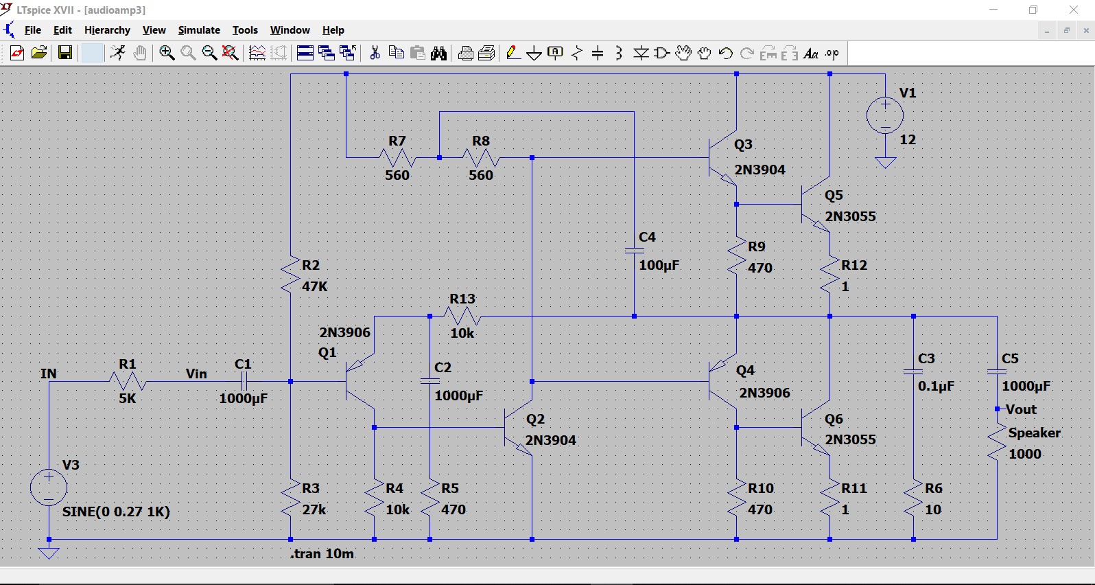

so I built this full circuit, using 3904s and 3906s with TIP31s for the two output transistors, that Mooly posted with the VBE multiplier, and I changed the 1K collector resistor to (2) 560Rs and a 100uF cap going to the output cap (not speaker side), here are my findings:
no changing of the preset resistor affected amplifier, when I disconnected on of the pins and nothing changed I realized the amp was just using it as a single diode bias, so I omitted it and tried diodes, as expected this just created what i'm assuming is crossover distortion so complete removal of the bias circuit was opted for.
Complete removal of the TIP31 with the 1 ohm emitter resistor going to ground does not affect performance at all.
the 10K feedback resistor going to the input transistor was changed to a potentiometer, I found anything over 220 Ohms increased power output greatly but also increased distortion greatly.
EDIT: I should note that the distortions I am talking about I ruled out overdrive.
Max undistorted output is 6v p2p.
this circuit has a max undistorted input level of 3 volts, for the applications I plan on using this circuit for this is desired.
Should I have heard a difference when the preset resistor of the VBE multiplier was changed? My meter has a blown fuse at the moment so I cannot measure the 20mA on the emitter resistors, I just figured I could dial it in by ear/with the scope. The circuit generates almost no heat (my shop is rather cold but I don't feel any heat to the touch) but i'm aware if I start increasing the power output somehow I will probably need the VBE multiplier for thermal runaway protection, so how can I get this working?
How can I increase the 6v output to closer to 10v or increase power output?
alternatively, it seems if I could remove the distortion from having a high feeback resistor value I would have the output power that I want (there is a significant volume drop with all distortion removed).

Congratulations on a successful bare bones build.so I built this full circuit, using 3904s and 3906s with TIP31s for the two output transistors, that Mooly posted with the VBE multiplier,
You could get more power by changing drivers from 2n3904/06 to a heat sinked transistor like TIP31, and cutting the emitter resistors on the drivers from 470 to 220 ohms. Usually having the drivers on a separate heat sink from the output transistors provides reliability advantages. Keeps thermal runaway from being quite so prevalent. I make heatsinks for drivers by cutting up scrap aluminum from window frames etc, then drilling holes in them. But you do need heatsink compound. Warning, heatsink compound is poisonous, don't touch mouth nose or eyes before washing hands. For heatsinks out in the open air you don't need insulators.
Usually in class AB, you can only get about 1/2 the power supply (rail voltage) voltage out. At 6 v peak to peak, you are below that, since that is 4.2 average voltage.
I'm using tip41c/42c for drivers on an AX6, driving TO3 MJ802 equivalent output transistors. But the heatsink for that was pre-drilled, a burnt up semiconductors dynaco ST-120. AX6 has same number of transistors per channel than your design. Very similar. I'm getting 70 W for a second at a time out of my AX6 on 8 ohm load with 70 v rail. For that I used heat sink on the VAS, too. A D44-R2. Retro Amp 50W Single Supply My AX6 card is post 212. Schematic is page 1. It has a few more resistors and caps than your design. I'm listening to the AX6 tonight, Little Steven's Underground Garage show just went off. Very pleasant sound.
For higher rail voltages than 12 you'll want to move to higher power output transistors. Biggest bargain in the US on single hole TO264 cases are MJL4281 npn MJL4302 pnp, or in TO3P cases MJL21194 npn MJL21193 pnp. You'll need to3-p heatsink pads for those.
I found some oddball 44 V CT transformers on e-bay for $10 that would give you about 62 v peak. Or you can buy what transformer you want from antekinc.com

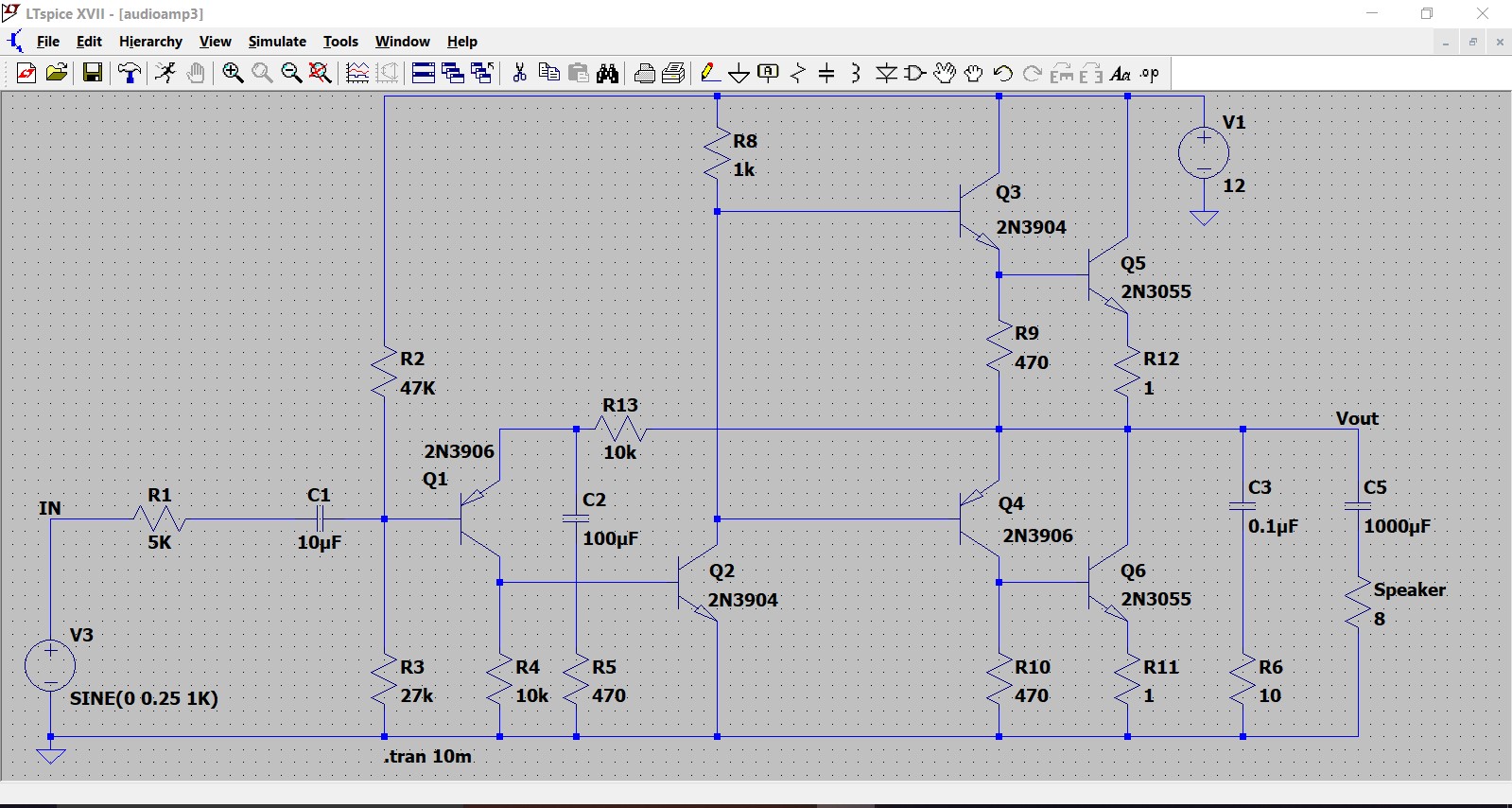

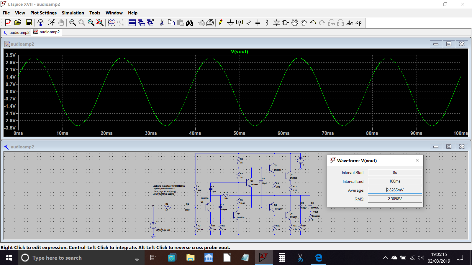

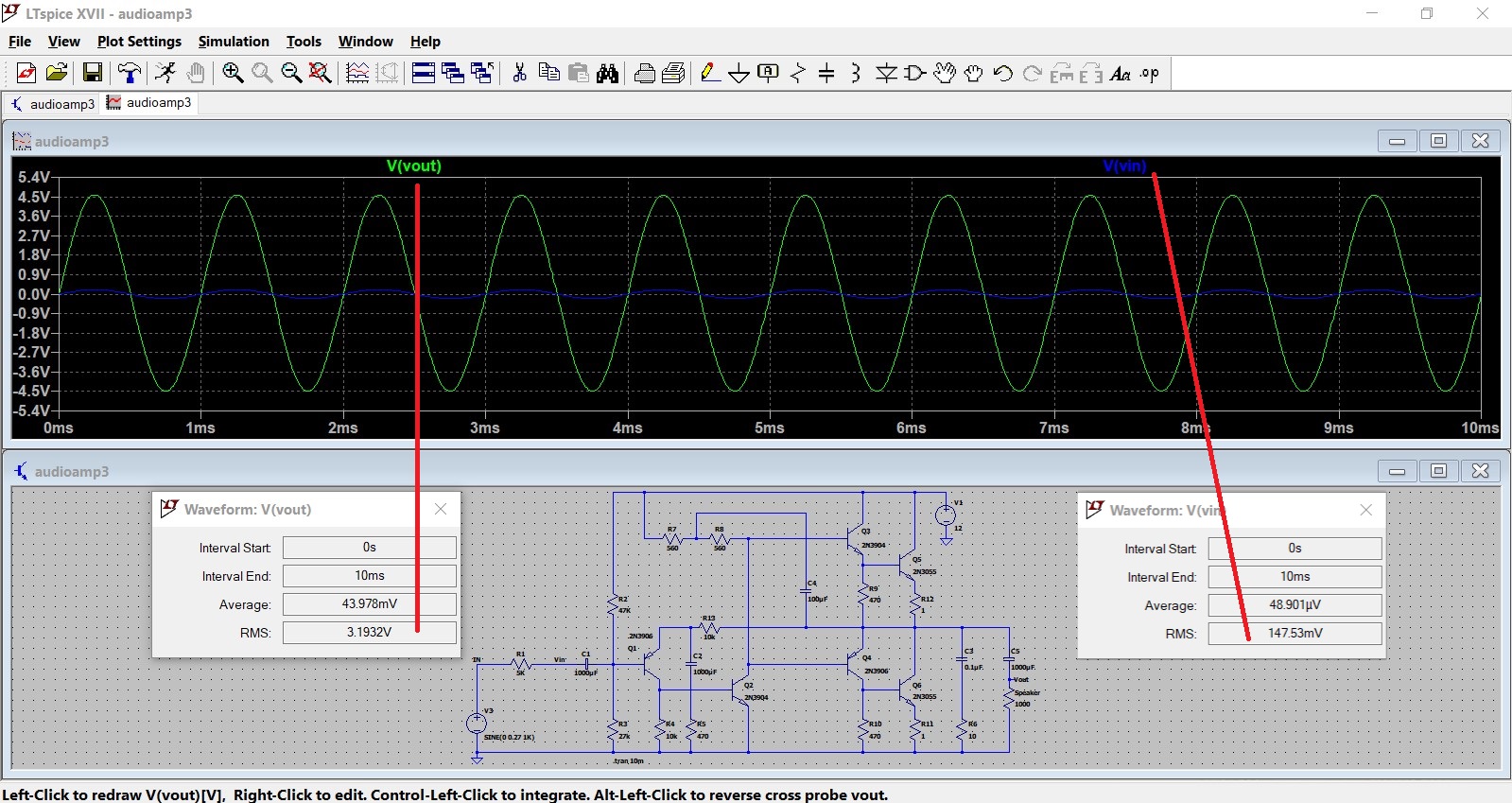

We can add what you did to the simulation. Notice the Vin and Vout nodes. The Vin node is the true input point of the amplifier.
For the purposes of the simulation I've also increased the value of a couple of caps (don't do this in the real amp) and also increased the load to 100 ohms.
The input voltage is 147.53mv rms and the output is 3.193 volts rms. If we divide them we get the voltage gain of 21.7
Now look at the feedback resistor R13 and the feedback return R5.
The gain of the amplifier should equal 1+(R13/R5). If you work it out you will see its pretty close 😉

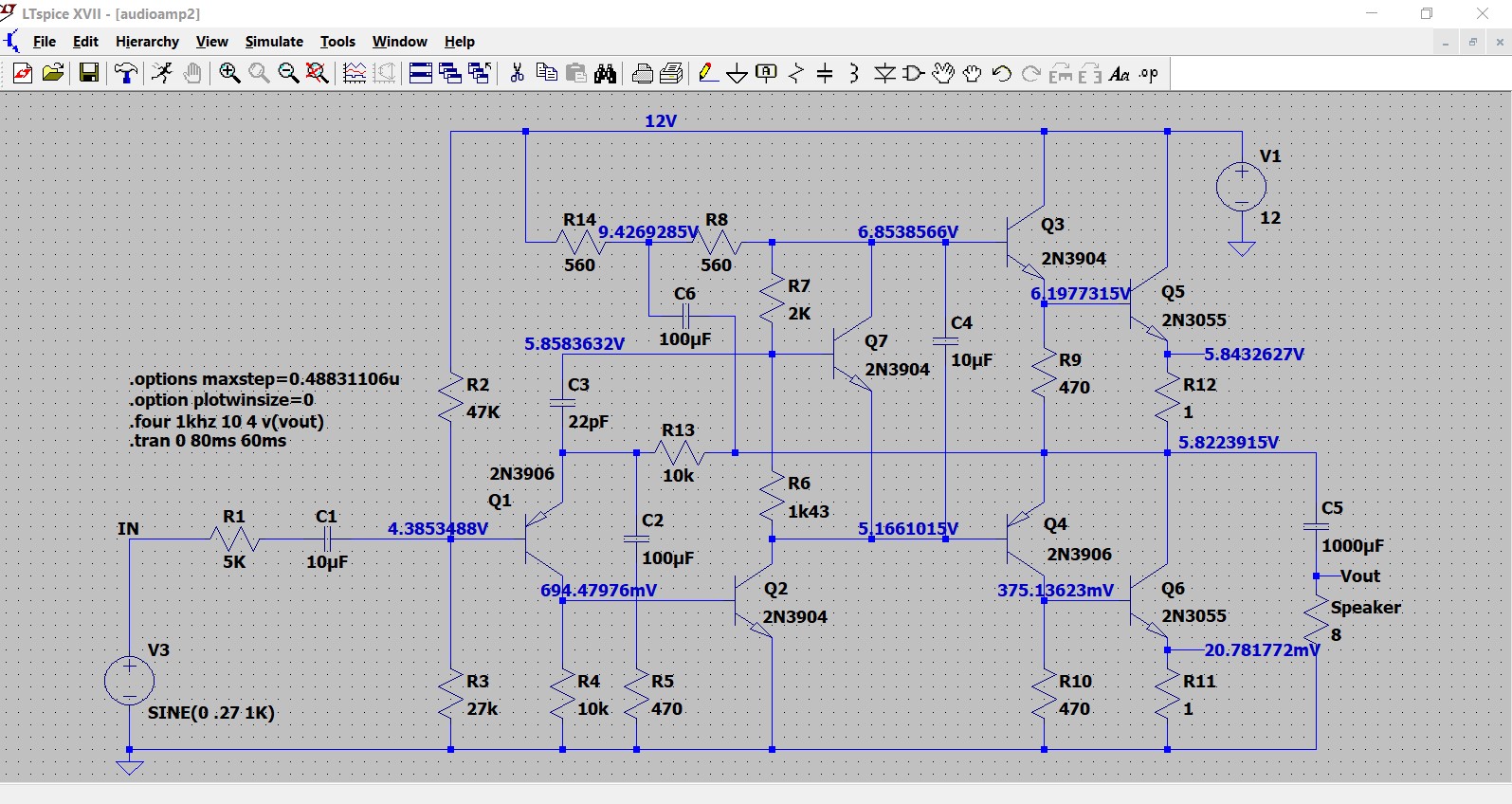

If you mean that removing Q6 in my diagram did not change things then that points to a construction error somewhere.
The Vbe multipler should allow significant current to be able to flow in the output stage.
You can derive the current in the 1 ohm by measuring the voltage across it and using ohms law. 20 milliamps would be 20 millivolts (V=I*R).
You should be able to measure and see change the voltage across the vbe multiplier as you turn the preset and for this type of amplifier you need to be getting around .
If you want to alter the gain then altering the 470 ohm is the way to do it... but be careful as to little gain can cause stability problems.
Last picture shows the typical DC voltages present.
