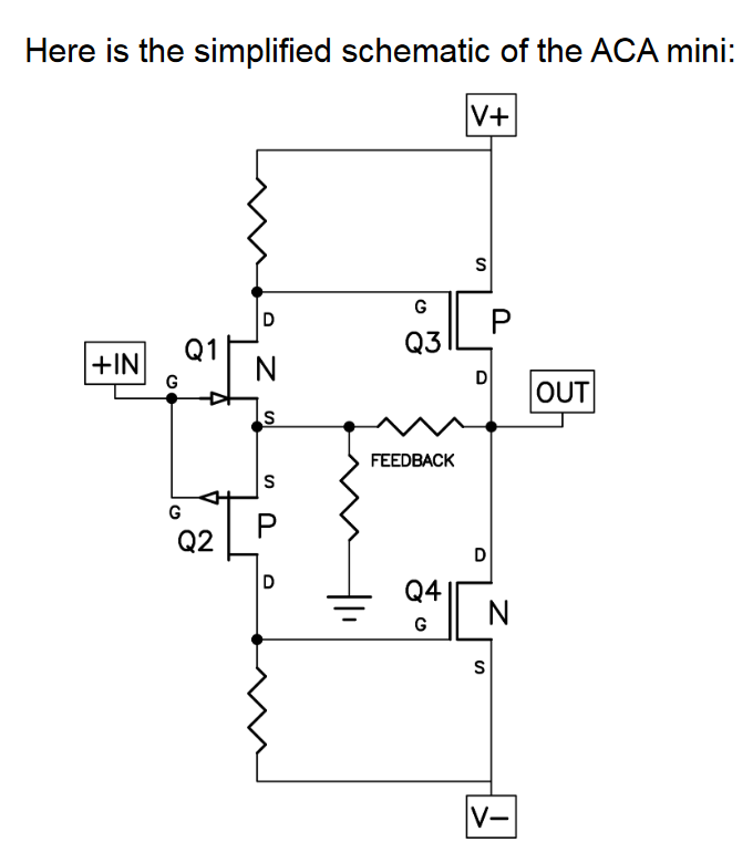

Do you consider the Hafler Transnova to be a transimpedance amplifier? Or how about the FirstWatt ACA Mini amplifier (shown below)?
_
This is clearly not a transimpedance amplifier:
...Mark's circuit above is a constant voltage output because while the load is driven by high impedance collectors, the global feedback is voltage feedback, so the output is constant voltage.
With the drains of Q3 and Q3 tied together, such a hard (unity) feedback is needed to avoid the output stuck on a supply rail.
Do you have this in mind?

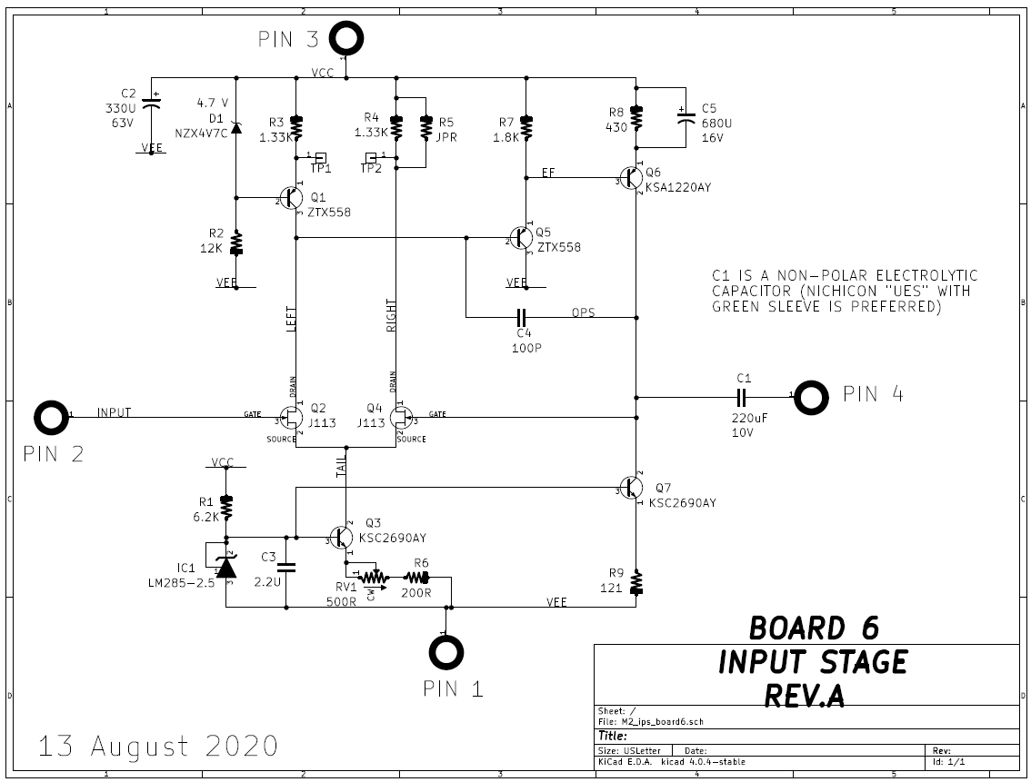

I went through these nested posts (dark side 2015 & good old tech 2013, both closed) to review this odd constant power / load invariant claims.
As per agreed with elvee, the NGTT does not what it claims. I've the impression that it was an invention by accident: the current mirror was connected wrong (the bases of T6 & T7 on the cathodes instead of the anodes), resulting in a 'rounded' transfer function, resembling a square law, and claiming the constant power (square-root) function, and thus 'tube-sound' too!
