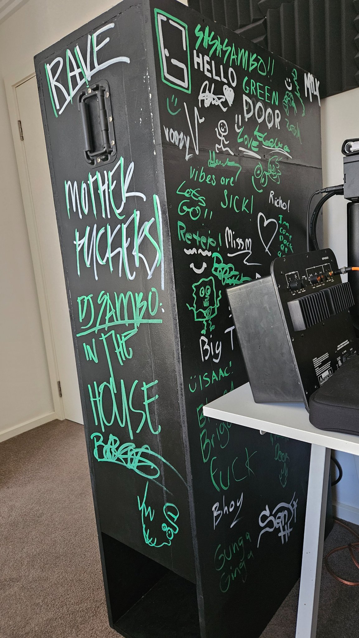

Thanks again for the interest. Below is a picture of the horn. (The writing on it was from the crowd at one of my parties)

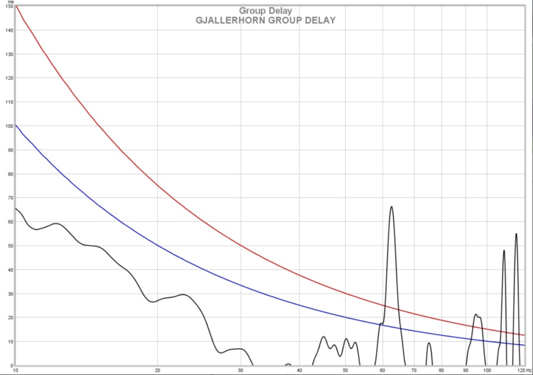

A small driver won't have the displacement required to enhance "first-cycle underrepresentation, especially below 60 Hz".

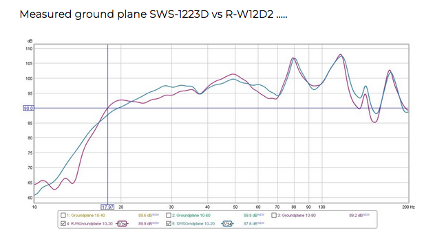

https://data-bass.com/systems
A well designed 20Hz tapped horn's group delay tail doesn't exceed one cycle duration (the blue line) below ~60Hz:
Most studies show even 1.5 x cycle group delay, (the red line) is imperceptible under controlled A/B tests.
In short: I'm not trying to erase the horn's nature. I'm trying to give it the punch it often lacks at the moment it matters most.
Your concept is based on the premise that "punch" below 60Hz is lacking and reduction of group delay will matter in your typical high-impact house parties and drum & bass rave events.
You could check your premise comparing SPL matched sealed woofers covering the same 20 to 50 Hz pass band as your tapped horn, using FIR filters to match phase and amplitude response.
The latency of those filters would be too long to be useful for live sound reinforcement, but not a problem for playback events.
