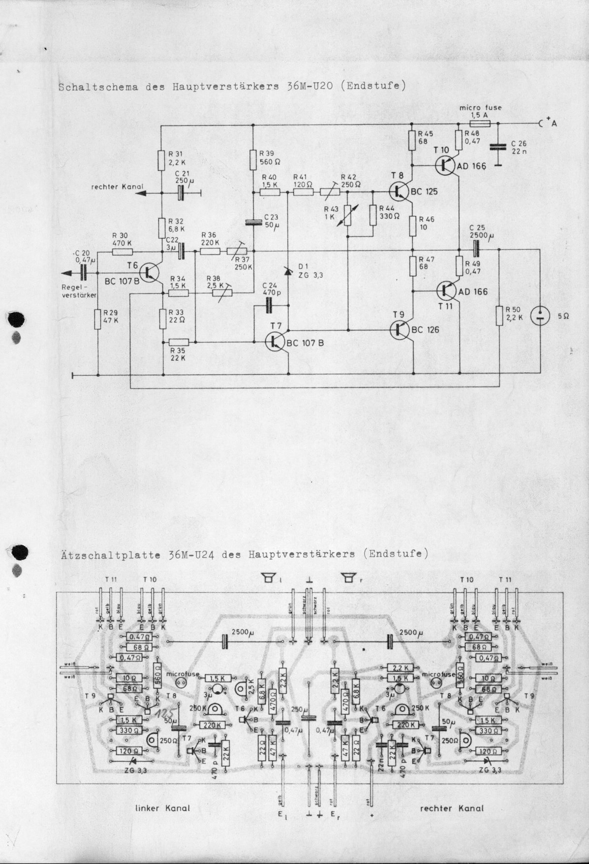

Gray sound or Transient Intermodulation distortion
Imagine each voice or instrument sound is a different color ,passing through the amp they must get squeezed out each ef them distinguishable ,similar to the tooth past that squeezes out red and white past .If the number of colors are few such as pop music ,all passes correctly, maybe whirled ,but distinguishable.The trouble starts with big orchestraras when they express altogether ,the amp mixes all these colors to squeeze a single color ,gray sound.
Before reading the joint document ,I advise you to hear first what it is .The best exemple that nearly all feedbacked amps fail, is the piano concerto [Tchaikovsky,Rubinstein ,boston,youtube] .Just the first 12 seconds are necessary .The orchestra bursts with high notes ,over-expressed purposely by the conductor. You hear at best ,the orchestra sneezing,at worst ,the artists fall tumbling upon each other.but in all cases a dirty sound.(please, do not blame theMP3).
If such events are rare ,more usual gray sound is with multiple brass horns. Whether it is walking band or a wide jazz orchestra ,in real world you feel an overwhelming sensation by the beat and textures of brass horns.When it comes to be reproduced ,you hear sometimes a single horn blown by an angry driver.Even feedbackless amps as single ended divinities ,true,they don't generate the headache, but they don't generate the expected pleasure neither. A notorious example is Benny goodman's ,Sing Sing Sing. 28 brass horns blow the sound of elefant after a jungle drums , and this ,occurring repetitively .Lucky you must feel if your amp do not pierce you ears before the ending.
I was also convinced that only single ended tube amps are exempt from gray sound.As an AD1/NF2 old radio I had ,was blushing all other amps in shame,transistor or Dynaco .
In mid 80's,well clothed , with the Rubinstein CD in hand ,I went listening it, on most unaffordable prestigious amplifiers. All vendors advised me to get my CD exchanged. Few years later ,all by hazard ,a thrown away 1967 DUAL CV4 , presented NO ANY GRAY sound.It was as clean as the best .
I used it as school to learn how to adjust feedbacks to avoid gray sound.You find joint the schematic and family picture .
I hope This post will be helpful to those who try to design for the better sound.

Grey sound is just noise modulation - its intermodulation distortion but not 'transient'. Calling it TIM will be a distraction from an otherwise interesting discussion about the role of noise modulation in 'dimming out' instrumental timbres.

I think, with those 1960's germanium output transistors and the singleton input stage in those early Dual models , that you are really just tweaking good old, straightforward harmonic distortion components - to get enhanced, musically pleasing sound effects. There's nothing transient about their distortion, it's simply in large quantities and low order (particularly 2nd and 3rd harmonic)
There's nothing wrong with pursuing that type of sound quality for its pleasing audiophile qualities. Also, for those like me who's hearing is slowly losing the definition once provided by higher frequencies. However, let's not give this mysterious titles that don't apply. There are many folk here and some who are very clever and successful at tinkering with amplifier distortion effects to enhance their "musicality". Perhaps by reading some of the current threads about experiments with various other quasi-complementary output stages, you will find something even more interesting and pleasing to listen to.
With more power, modern components and definitely less noise than those old Dual models, you'll soon see the greater benefits of DIY designs, should you take up the activity 😉
