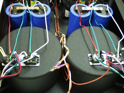

I am crazy with my 2x LONO 1000va each at 90vct ac ? no sir... I try it with 630va(already 4 time your and industry standard) under same chassis(exactly same voltage 4x 0-45ac),all from plitron No contest here, with 1000va it is magical and effortless, amplifier disapear ! not box at 130 pounds 😀
But will follow AndrewT suggestion for better grounding !
