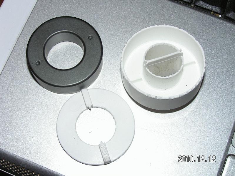

I have some common mode input chokes from power supplies. They are wound on donuts with 20 mm internal diameter, 40 mm external diameter, 12 mm thick.
Each winding has 41 turn, 18.2 milli Henry.
The question is, what material can it be? What is saturation induction, and how much power I can pass through them for a power amp from 3 kHz frequency?

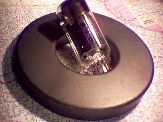

You need 4 or 5 of these (attached) 6 inch ferrite toroids stacked up to do a 100 Watt standard audio OT. Like $50 each unless you get samples.

The FDK designation comes from Fuji, so the cores are on the old side. It doesn't appear that Fuji is in the ferrite business any more, but I may have some old data squirreled away (no promises, though). Trying to do a 20-20k transformer with these cores would be insane, but a transformer working from 5k-up would be doable. The equations given by Smoking-amp are a good guide, especially the second, which is the classic "transformer" equation. Rearrange it so you can figure out the turns needed for a given voltage and flux swing. Once you get the volt-seconds issue dealt with, the throughput power will be determined by the copper losses, keeping in mind that the saturation flux density of the ferrite goes down with increasing temperature, so it is inadvisable to let the core get too hot (it will get heated up by the windings).

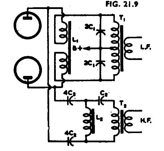

I thought about this once also, RDH4 has a frequency splitter/combiner circuit for a dual freq. band OT. (page 888) Maybe for use with a dedicated speaker setup.
Trying to do the LF or the whole band (ie 20 Hz) looks impractical to me with ferrite. (5 six inch cores!) Huge cores. Winding capacitance issues at the top end. I've heard some negative comments on line before about some attempt at a ferrite OT, ie sounded bad, but I doubt if they really used sufficient ferrite.

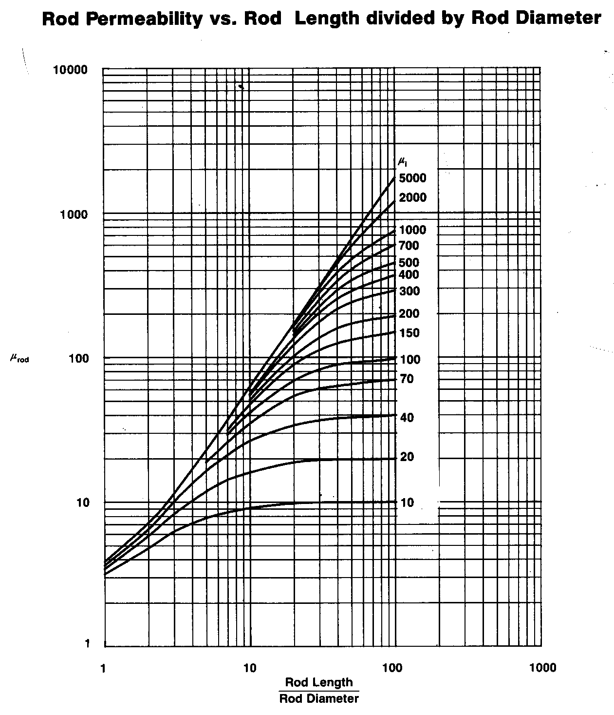

A long thin winding is optimal for low leakage L. If you want to get the low frequency down further (maybe 500 or 1000 Hz), try winding it on a large ferrite rod. I've seen 3/4 inch diameter by 8 inch long rods. You will only get around 60 Mu effective that way due to the air flux return path (see the attached diagram from Fair-Rite products catalog. These curves assume there is some 1 or 2 inches of bare rod at each end like a typical rod antenna. Winding out to the ends will lower the effective Mu since there is less rod to radiate flux out on the end). But you can improve that considerably by stacking a bunch of toroids over the whole rod & winding assembly to provide the return path. This still won't get near the intrinsic Mu of the material due to the residual gapping, but maybe a few times better than the plain air return effective Mu.
Note: the typical ferrite rods around are low Mu (20 to 300) and low Max Flux (1/2 of power ferrite), since they are intended usually for HF radio antennas.
Although some called "Impeder Rods" for welding (arc noise suppression) may be higher Max Flux. So if the scheme works out, and a bunch more are planned, I would get some custom ferrite rods made using power ferrite material. (Fair-Rite Products obviously does such stuff). Or you could try stacking up a bunch of small toroids (ebay) to make the "rod" core, with bigger toroids stacked outside to form the outer return path.

Well, there is this setup from page 888 of the RDH4 (attached). Also see page 185. But that takes DC inductors. A more practical setup would be to just do two amplifiers (a small one for the HF) on the same chassis using the same B+ power supply with a freq. splitter (RC) network at their inputs.
