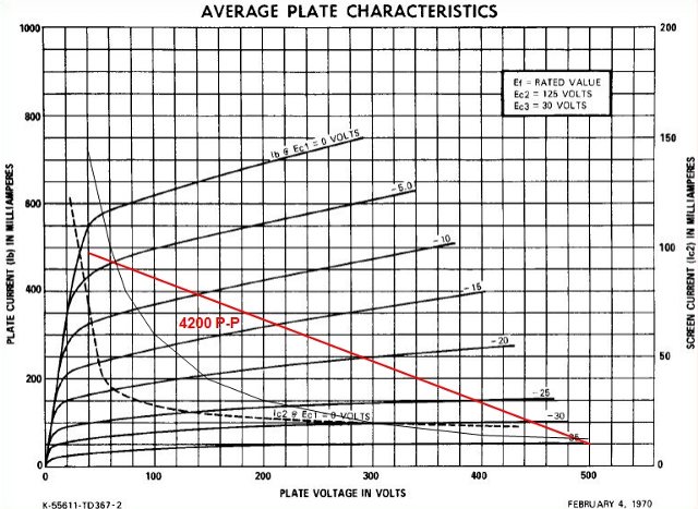

What is your power output and damping factor goal?
Eb=500 and Eg2=200 are within the max ratings for the 6LQ6 but don't make sense for 30 watts dissipation in a class AB audio amp.
If you want to run 6LQ6s at 500V, I think a better Zpri might be in the 4000 ballpark. There is no reason to run g2 over 120V. This would give you about 100W output in AB1, and would be close to the 30W dissipation limit. It would also give you a reasonable damping factor without too much NFB.

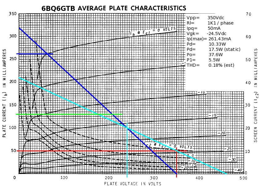

Can anyone suggest what transformer impedance I should start with for push-pull sweep tubes?
Since these horizontal deflection types tend to operate at higher currents and lower voltages, they aren't going to require such high impedance transformations.
Here's a loadline for the 6BQ6GTB. As you can see, it requires just 1K1 / phase. That gets you better than 37W, and the Pd spec busting doesn't matter in audio final service, as this is much less demanding than horizontal deflection duty.
I happened to have a NOS, Stancore OPT that was originally intended for use with Class A 6L6s that worked just fine here, other than the 30W rating, and that the core saturates before the finals actually clip. I'm still getting 32W of output.

Good morning Michael,
I came across an OPT rated at 60 watts and a primary Z of 4.2K. What do you think? I haven't found any 100 watters with that kind of primary Z.
Ray
Ray
That one would work but be a little undersized.

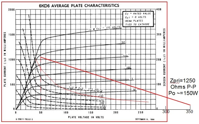

6LF6 is a wonderful tube. I used it in screen-drive with 1250 ohms plate to plate and a 650V plate supply. Easily hit 150W, with a reasonable distortion spectrum. You could probably do something similar with running AB2 pentode. The basic idea is to take advantage of the perveance to get watts without excess screen dissipation.
SY,
Something here doesn't add up for me. I don't have 6LF6 plate curves, but I'm looking at a very similar tube, the 6KD6, which also supports a 1250 ohm P-P load.
It looks to me like only about 350V B+ is needed to produce 150 watts into 1250 ohms P-P load (class AB screen drive).
I also plotted 40W plate dissipation on this chart to represent the 6LF6...
Michael

Yes, one has to avoid melting the tubes- that's probably the power limit. Unlike George, I don't like killing output tubes just to see what happens. I'm sure I could have gotten more power for a short time...
My amp ran near-class-B, so it was pretty cool at most usage.

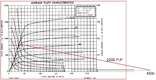

smoking-amp's traces of a 35LR6 (6LR6 with a 35V heater) line up almost exactly with the published 6KD6 curves so I think these are representative of a 6LR6.
http://www.diyaudio.com/forums/tube...-new-p-p-power-amp-design-27.html#post2080702
450V and 2200 ohms would be another possible OP for 150W Po as shown below.
Ray, you might get the idea by now. A wide range of primary impedance can be used with B+ and Vg2 scaled to the load line at your desired Po, as long as you don't exceed Pd. As George says, 2500 ohms - 3300 ohms or others can also be used.
If you are planning to use Schade feedback, there are limits on the output resistance achievable at the speaker terminals based on the gm and OPT ratio. It's something like 1/gm * (Zsec/(Zpp/4)) for class AB assuming V/I feedback to a pentode driver. For example, a pair of 6LR6 at gm~=13000 into 2200 ohms P-P would have output resistance on the order of 1.1 ohms using Schade feedback.
