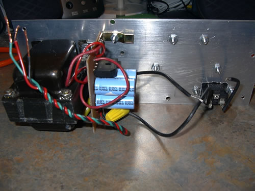

I am building a lm3886 subwoofer amp, and want the thing to look professional. So, I bought an aluminum plate from Science and Surplus (a local surplus store), and assembled the thing on it.
IS it safe to have the transformer mounted directly to the aluminum? I know that nothing happens when it is touched.
Here are the pictures of the unit. The amp is not done and I have to get around to drilling the hole for the switch. All thats on there is is the trafo and power supply board.
Is this safe?
