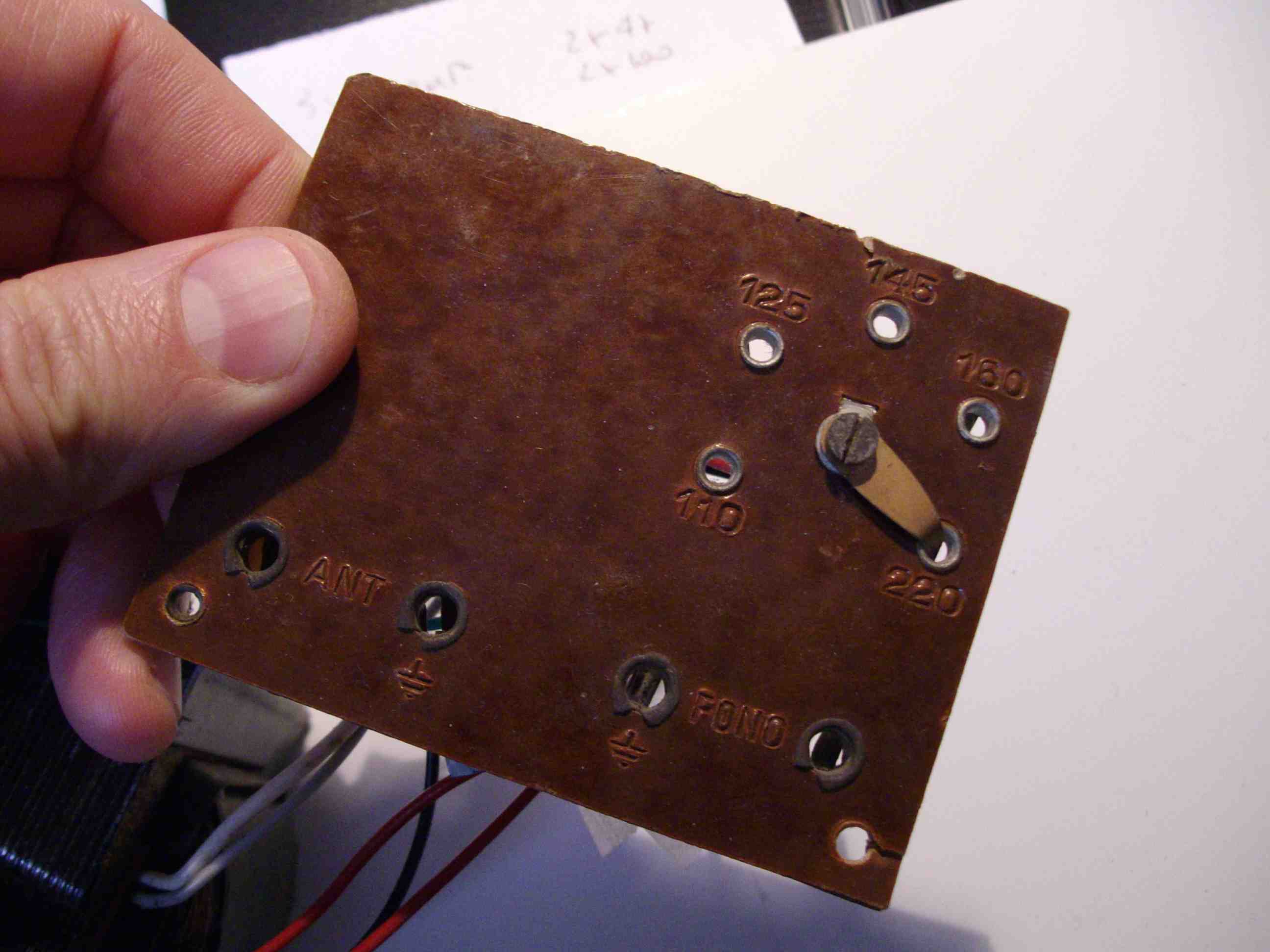

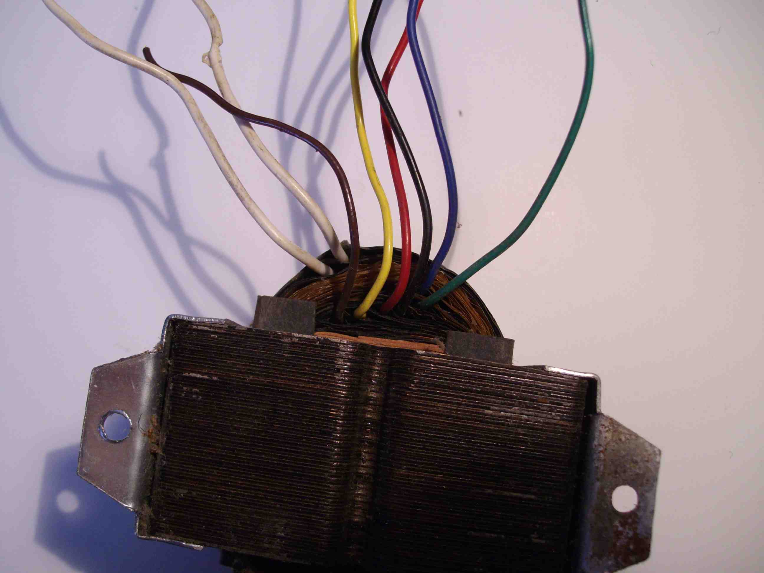

Just scavanged this transformer from an old tube radio and I don't understand its wiring.
Primary:
these were connected to voltage selector:
blue 220v
green 160v
black 145v
red 125 v
yellow 110v
but what about brown and 2 white?

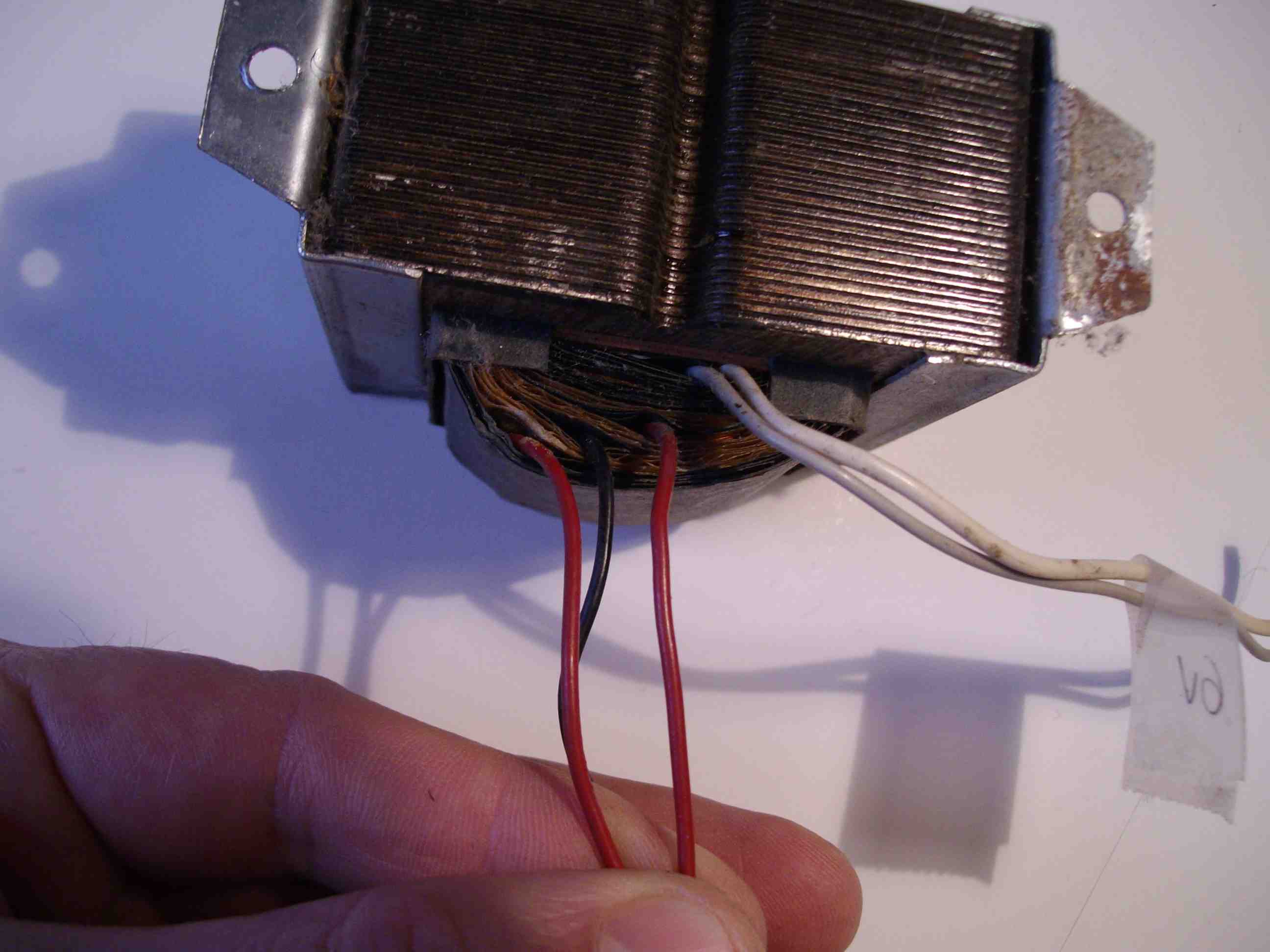

Secondary:
I've checked when still working in the device
2 red 400v
2 white 6v
what about black?
I wonder if there is some kind of colour code (I read red for anode and white for heaters) or how calculate unknow values...

The black is probably the center tap for the red wires and was connected to ground. You can verify this with an ohm meter, the resistance between the black and either red wire should be half of the resistance of that between the two red wires.
I measured 300ohm and 164 ohm so it is 400-0-400.

I'v e checked for continuity.
"Primary" wires: continuity between
-green
-black
-red
-yellow
-brown
no blue and no 2 white

Some resistance values:
between:
brown and yellow 9
brown and red 12
brown and black 16
brown and green 21
brown and blue 59
between 2 white "primary" side 5
between 2 white "secondary" side 5
between 2 red "secondary" side 314
between one red and black 164
Once again I hope this means something to you
Is blue isolated from every other wire end?
If so then it could be an electrostatic screen between primary and secondary.
Can you tell if the brown wire is wound closest to the core?
That could be the "end tapping" of the primary winding.
You need to find the other "end tapping".
It may be the blue wire showing 59r
Check the resistance from blue to all the other primary wires. Are any more than 59r?
Check from Yellow to all the other primary wires. Are any more than 59r?
Once you know that you have found the highest resistance winding then it is safe to assume it is the main connection for power in.
With all the wires still safely screwed into their separate terminals, connect the longest winding via the bulb tester to mains power.
Stand back and switch on.
Did the bulb glow, or flash, or nothing at all, or go bright. Stop there and report back.

This is not good...........I have connected them via the bulb tester to mains power and the bulb glows.
With the Bulb still in circuit:
Can you safely measure the voltage across the Brn Blu?
Can you safely measure the current through the Brn Blu?
Voltage is 183v
Current... with DMM set at 10A and at 200mA is zero, I am probably doing something wrong but I'm afraid of burning my DMM
Do not insert a multimeter into a circuit to act as an ammeter.
Instead insert a low value resistor and measure the volts drop across that resistor.
But be careful, that resistor and it's wiring is at mains voltage. Do not kill yourself.
183Vac means ~40Vac is dropped across the glowing bulb. The circuit is drawing significant mains current. There is something wrong.
