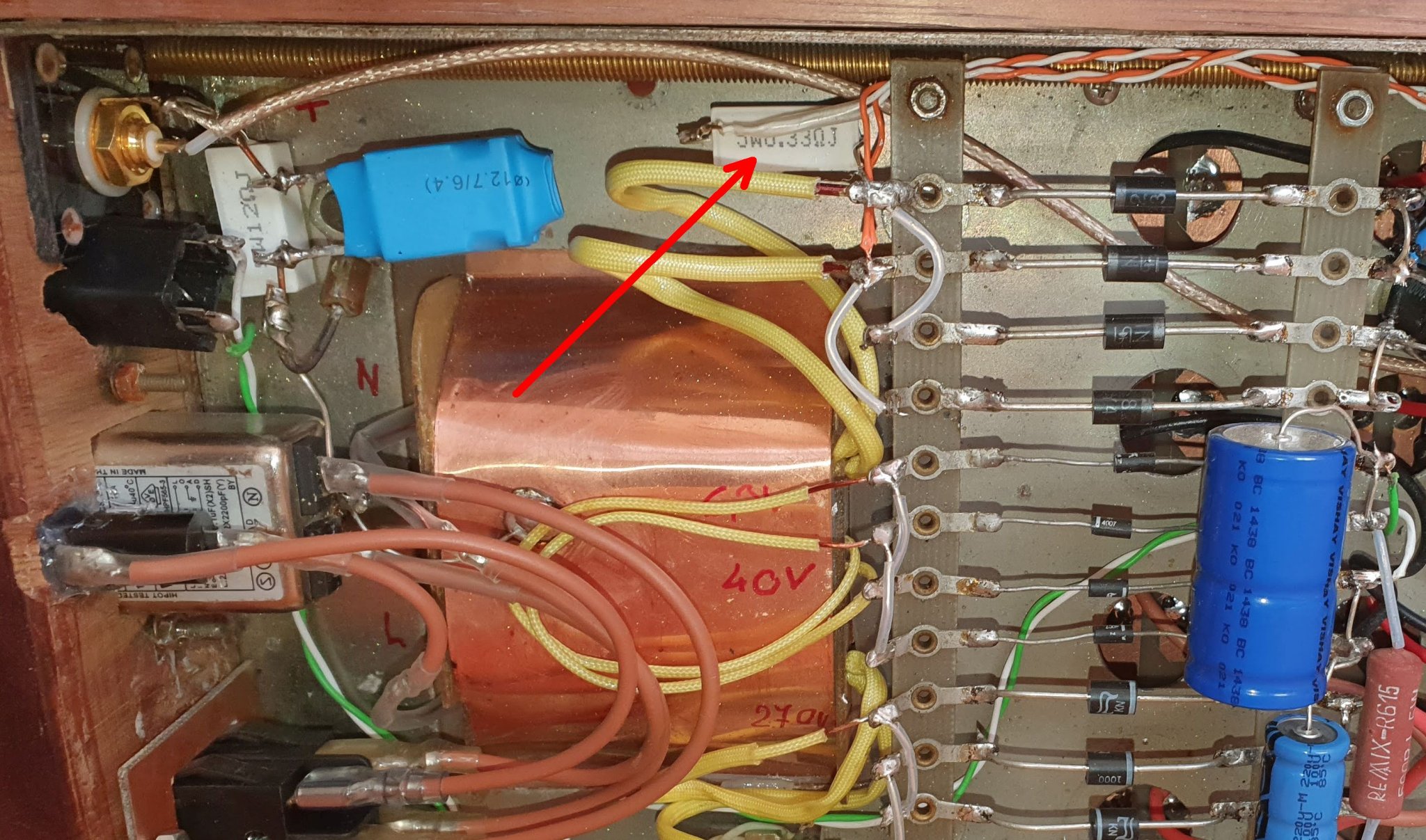

12V sounds pretty high for open circuit voltage, my 2.5A 220:6.3x2 transformer for my 8136 OTL amp was around 9.5V, but my line voltage is also 230V and not 220V.
I'd put a resistor in series(bolted to the case or a heatsink probably) like suggested by others unless you can get it swapped for a lower amps one. That's how I fixed this with my filament transformer at least

That’s why I said to load test the HV. It may drop a lot more than the filament winding.Is the HV reading proportionally higher, too?

Put a known 6.3vac on what should be the 6.3 winding and measure the input leads to see what the transformer is expecting to see. That will verify things for you. If the HV windings are unloaded the LV will be higher than expected.

Finished the wiring and hooked up the HV and now the voltage is spot on at 6.26v!
Sorry for the fuss, guess it was for nothing. It had never happened on other transformers (wound by the same company), so I was slightly worried.
