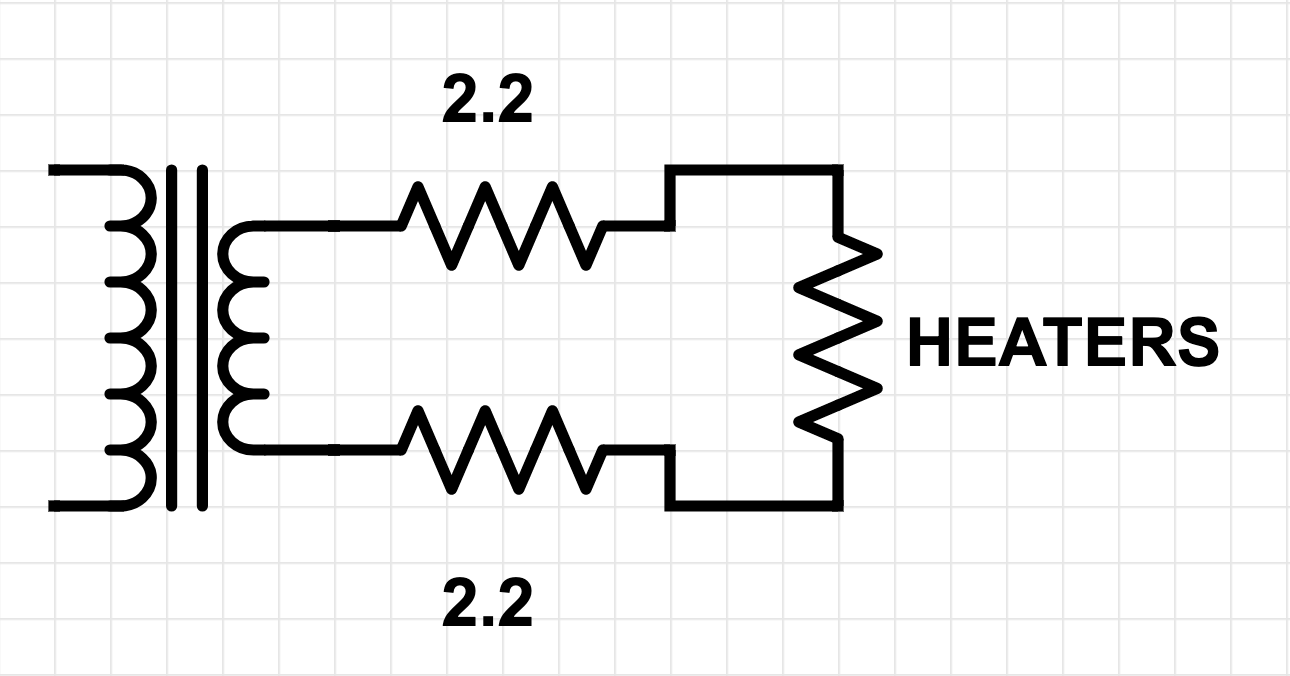

  • I've already bought 2x2.2ohm resistors rated at 10W, I've put them in parallel to the tube heaters but the voltage didn't drop at all. I'll try putting one on each winding in series (as shown in the attached picture)

Have you tried using the two 2.2 Ohm resistors in SERIES with your tube heaters instead of PARALLEL? I guess that will make a big difference!

My guess is that he was trying to put additional load on the winding and see if it dropped any.
Yes indeed that's what I was trying to do but had no luck.
Therefore following y'all suggestions I'll be wiring up the heaters as follows (I meant to attach it earlier but forgot):
