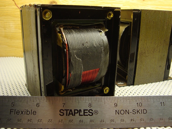

OK So I hacked into a 35-0-35 Power transformer. I want to lower the voltage for a chipamp project.
I was able to unwind the top layer of the secondary to get down to 18.6v.
Now to get to the 2nd secondary I will have to unwind the rest of the "18.6"v and rewind it, or..........
........I also have a second transformer I could also just unwind one of the secondaries on it and voila I have dual rails via dual transformers. Any advantage to this or just a complete waste of iron?
I also understand the VA rating will go down from 250VA to some lower value, any guestimates?
I also am aware that a higher voltage would use thinner wire and lower voltage uses thicker wire. Am I OK to use the "35v" secondary wire for "18v" use? It's diameter is 1.63mm / 0.253".
I thought I should ask before I went to far.

Yes your VA rating will go down.
Your 250VA transformer was rated to produce approximately 3.5A.
Reducing the number of turns will certainly reduce the secondary voltage as you expect but the windings are still only rated at 3.5A.
If you want to go the whole hog. Strip the secondaries completely and rewind two new secondaries.
If you've reduced Vs from 35V to 18.6V then the VA rating will be dropped in the same ratio - approx 130VA.
There are other factors involved that may increase this somewhat but they are there for safety in the original design.

OK say if I strip the secondaries and rewind, should I go to a bigger gauge wire to fill the space left from removing the turns? (I don't actually have larger)
I will try it with the original wire, my gap will increase a bit more when I unwind the other secondary.

I am starting to lean towards using the second transformer for the second rail rather then risk unwinding and rewinding the rest. I am not confident I could strip the wire and have it completely intact for rewiring. I played wit a scrap piece, it is possible for the enamel to chip off with the potting lacquer.
Yes, generally you can't reuse enamel covered wire because of the risk of insulation damage. Wire voltage depends on number of turns. The maximum voltage depends on insulation thickness, which may be on the wire or added extra when winding. Maximum current depends on wire thickness and how easily the heat can get out. If you want to get similar VA to the original transformer, then rewind the new lower voltage secondary with thicker wire which will just fill the space occupied by the old winding. Unless you have the necessary machinery you are unlikely to fully achieve this at home.

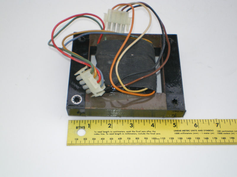

I have a bit of a plan B
I have a line on a dual secondary 25V, 3.2A per secondary. Does this sound OK for a Daniel's LM3875 Chipamp? I'm not sure how to calculate that back to a regular "VA" rating.

Here is a picture of one PT with one secondary unwound to 18.6v.
It appears that each secondary is two layers thick, so the halfway point would be at the sides.
I could try to snip the secondaries in half on the untouched PT or get some new magnet wire, strip and rewire the secondaries on the one I have hacked into.

OK so I will do something with these later on but I have decided to go with plan "B".
I will do something with your advice so it is not wasted!
I made an offer earlier on 2 of those slim transformers and it was accepted.
So now I have two transformers coming that are 2x25v 160VA for a total of ~320VA for a stereo pair.
