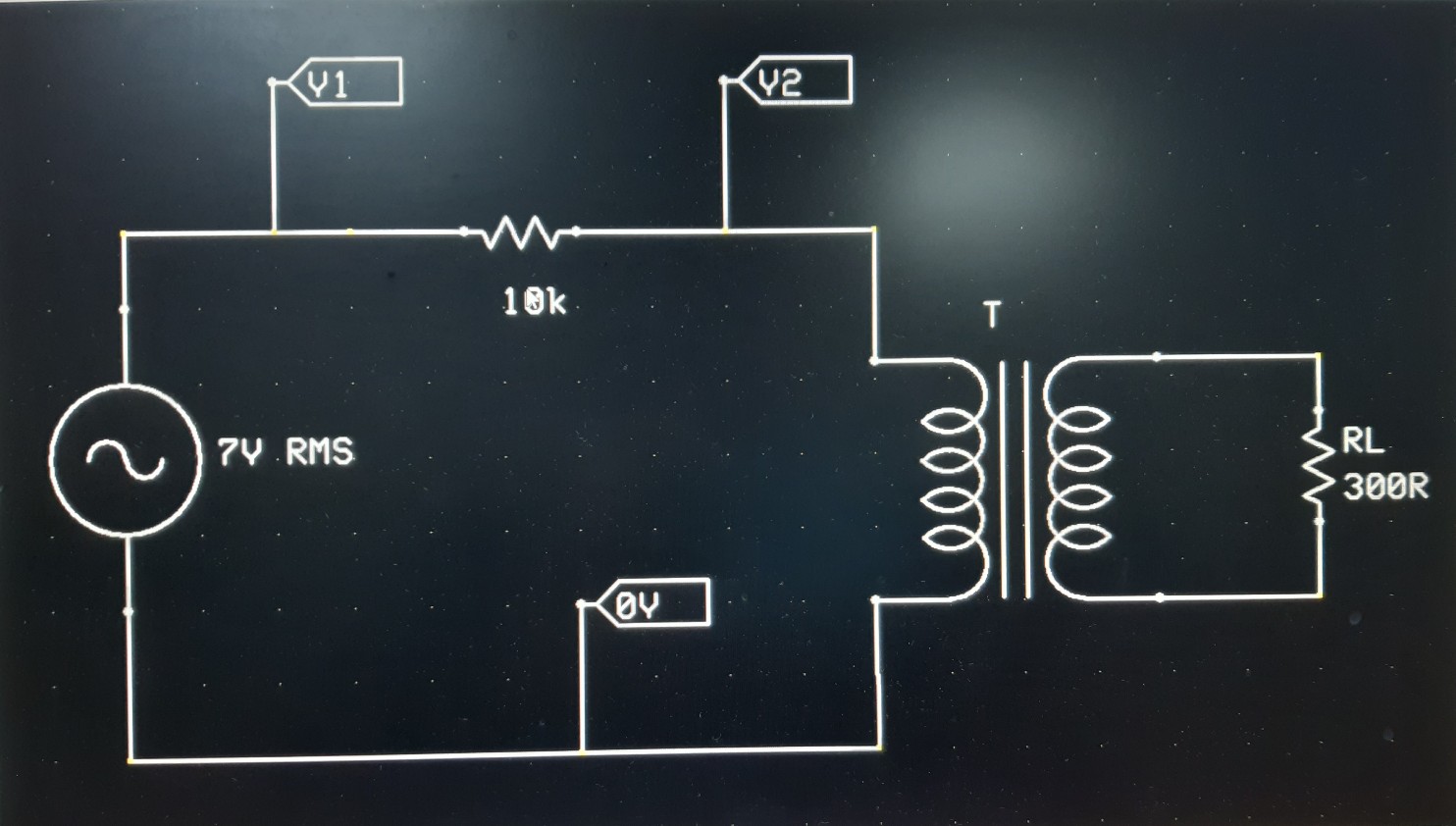

Testing
Thank to PRR for the suggestion to measure impedance via potential divider method, at the time the obvious method escaped me. No excuses for that haha.
Attached below is my test circuit (essentially the same as PRR attached, but with more practical value of resistance - 1M is far too much)
Switching to using 10k resistor, mainly due to my expectation that I would measure transformer impedance in the order of 10k, gives me much better span of voltage to work with : I.e. half signal voltage when Z = R = 10k

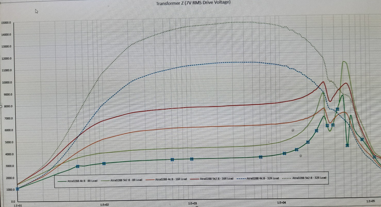

Some results
In the attached plot I have tested the SE OPT for a baseline comparison:
4k:8R - 8R load,
5k2:8R - 8R load,
Further curves for increased secondary load of 16R and 32R.
What leaps out at me is the rather large resonant peak, doublet/triplet of peaks in the range above 30kHz.
That's not nice, at all!!!
now I see why they were quite cheap...
As I'd expect the BW is reduced, with increased attenuation of both low and high frequencies, when the load resistance is increased.
In the case of this OPT however, running and increased secondary load is probably a good thing!
What else is noticable?
Well for one thing, with a Z ratio of 4k, the measured Impedance peak or plateau, is somewhat lower, 3k3.
In fact all measured impedance BW for all tapping are between 20% and 50% lower, with the situation worsening for greater increases in load resistance.
One configuration is close to my 10k to 15k target, the dashed blue curve, 4k:8 using 32R secondary load.
This gives about 10k impedance between 200Hz and 20kHz.

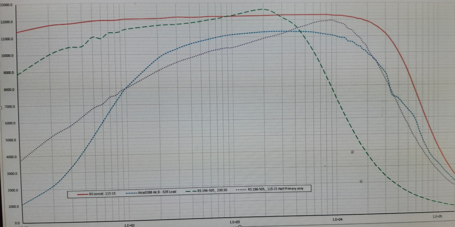

Toroid-further comparisons
What started this was my original circuit, using RS 196505 30VA toroidal main transformer as OPT, and managing to achieve a pretty decent 50mW output at less than 1% THD measured at 1kHz, and also 100Hz, but awful at 10kHz.
Does THD at 10kHz matter? Maybe, maybe not.
Referring to the attached plot,
The green dashed trace shows the impedance BW of the toroid; about 11k5 at 100Hz, and about 12k at 1kHz, with peak Z at 2kHz.
Impedance drops like the proverbial stone after 3kHz, and THD rockets to 5% or more at 10kHz.
Interestingly, primary Z has seemingly more influence than anything else.
In the Violet trace, I have paralleled the Secondaries, and only use one primary winding, for 115: 15V essentially keeping the ratio very similar, but reducing the primary inductance or lossy capacitance (truth be told I'm not sure exactly which is more at play here)
The results are middling - better Impedance at high frequencies, balanced by loss of loading at LF and lower overall impedance across the BW. Shame.
The little RS 1.6/3.2VA toroid is a bit of a surprise.
Using all windings whether in series or parallel, to preserve turns ratio, lead to a Impedance BW which was already in decline by 1kHz - no good for audio I guess!!!
Taking a look at the Red curve and, to my non expert eye, the Impedance BW is really quite impressive, 12k loading from about 50Hz to 18kHz.
So, is that what I am looking for, as a good Impedance load for my valve circuits?
Flat, non resonant, extended BW?
Should I really be designing for REAL impedance BW rather than Z ratio?
Or rather, should I be saying to myself:
" I want a Z ratio of 15k, but I know that real Z will be 25-50% lower than this; so instead I'll opt for a Z ratio which is 25-50% high, in order to accommodate this?"
Any answers on a postcard, SAE or comments, are welcome.
Thanks.
Having sat and considered my test setup, I may have done something slightly wrong...oops
Measuring volt drop across the series resistance, and using that difference voltage to calculate the current through Rs. Then using that current value with the voltage divider tap, to calculate Z.
All the while assuming the level I set on the Sig Gen is what is output at all frequencies.
Using 330k rather than 10k series resistance and I get a different result.
What am I doing wrong here? With a higher Rs I am left with small voltages to measure.
So I set about inserting a microammeter in circuit to check my results.
With uAmmeter in circuit my AC current readings tie up with calculated (10k Rs), and also when using 330k load, within reasonable tolerance, considering the measurement is between 20 and 500uA to the limits of DMM AC current accuracy (15kHz).
So perhaps my method is not at fault.
Which leaves inaccuracy of voltage measurements when using 330k Rs for the difference in results, where Rs is 10k and 330k.
Any further discrepancy, I guess is due magnetisation losses at lower AC current.
Though ìm probably missing something else, and some reader will be having a good old chuckle!
Any ideas?
Or advice?
Am I right to be using a smaller value of Rs like 10k to measure impedance of the transformer?
My reasoning for not using 1M (referring to PRR posted circuit):
*Larger signal to measure, reduced measurement error when using 10:1 scope probes.
*less influence on readings from measurement instrument (using Rs of 1M, and scope input impedance of 10M, some loss of signal is expected)
*Testing the transformer with AC currents that are closer to what it would experience, in use.
My doubts:
*Using 1M and 1V signal, as in PRR example, is the assumption made that the R is high enough to be considered a constant current source? I.e. 1uA - if so then this could explain the differences.
I think you are going way over the top with regards to expectations of a mains transformer in your application . I find using toroids as output transformers fine , as long as you drive with a low impedence . You would be better off having some custom transformers wound which fit your specifications . I am pretty sure there are also some pro-audio transformers with 10K primary and 150 ohm secondary which may be suitable , try Canford Audio
