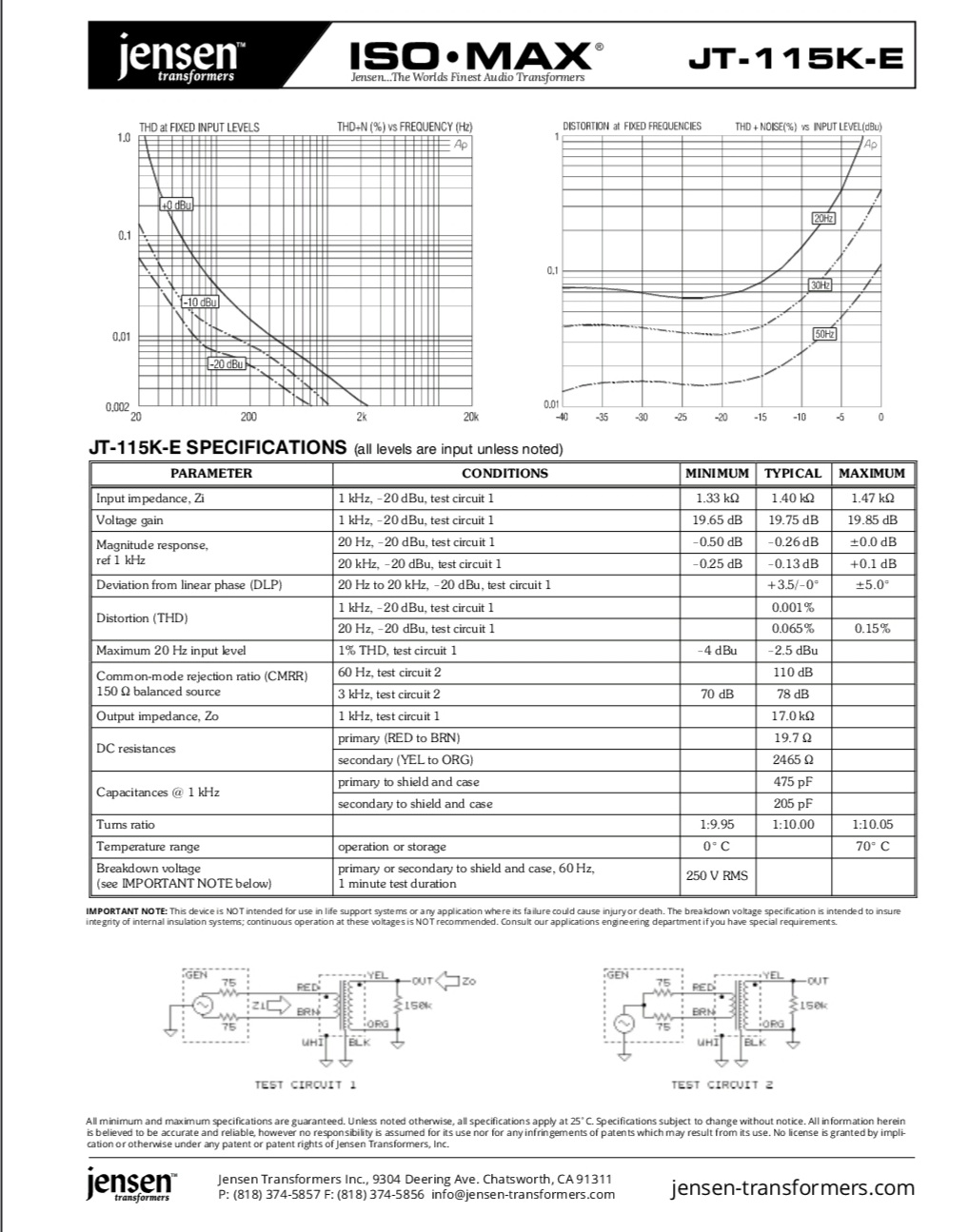

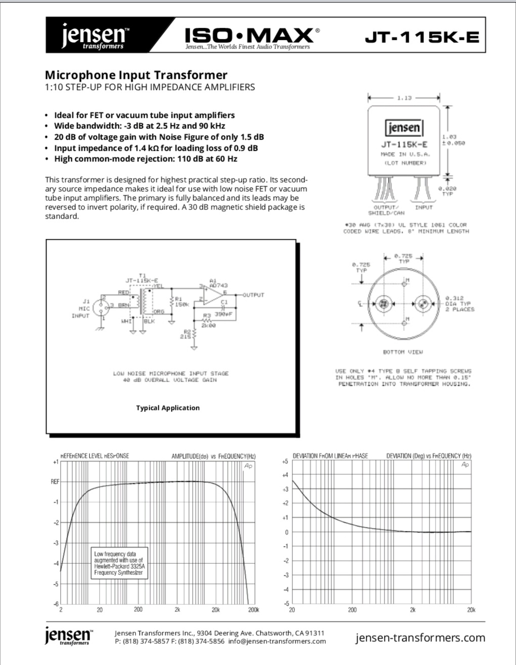

I have a set of these Jensen transformers and was curious if they would be useful for MC step up with a low output MC cartridge?
The winding and DCR ratios suggest a possible good fit for MC step up. Aside from shielding and FR linearity, is there anything else I'm missing from the equation which would define these transformers as being a good fit for purpose?
If this transformer isn't a good fit, does anyone have other good suggestions for reasonably priced, decent MC step up transformers which would play nice with low to medium output MCs? I'm running both the AT OC9/II and an older VDH MC cart. Both are low output units.
