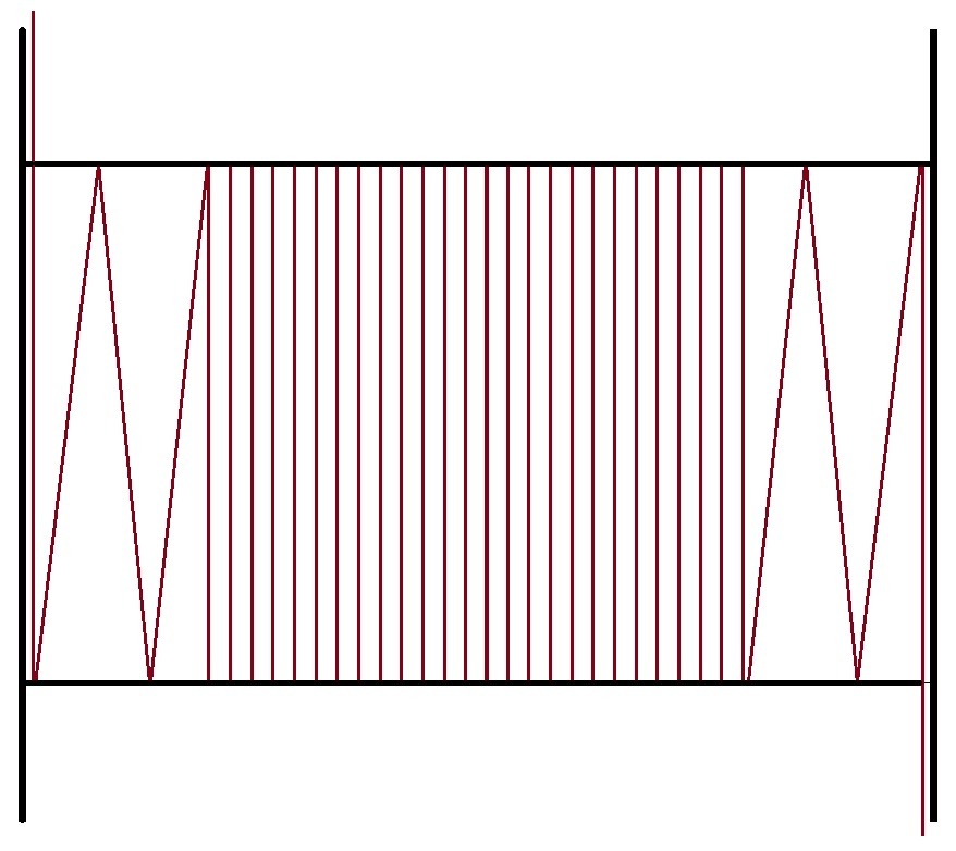

Transformer spiral winding
When winding output transformers I've come across the term "spiral winding" of the secondary windings.
The idea is that sometimes the secondary windings won't fill the whole width of the bobbin.
This will cause increased stray inductance, and the remedy is spiral winding on parts of the bobbin.
So, my question is;-is this what it would look like?
Very much doubt that is a real problem.
Stinks of overthinking and "non solutions for non problems"
And in any case, will apply to one layer only, the last one, since all others have been filled end to end by definition.
IF there is any influence, it will be microscopic.

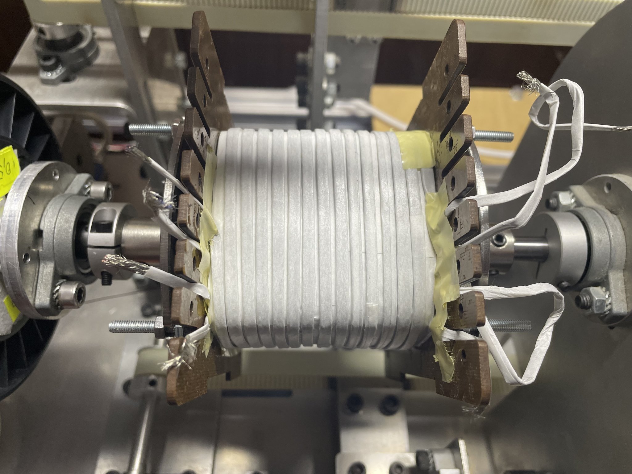

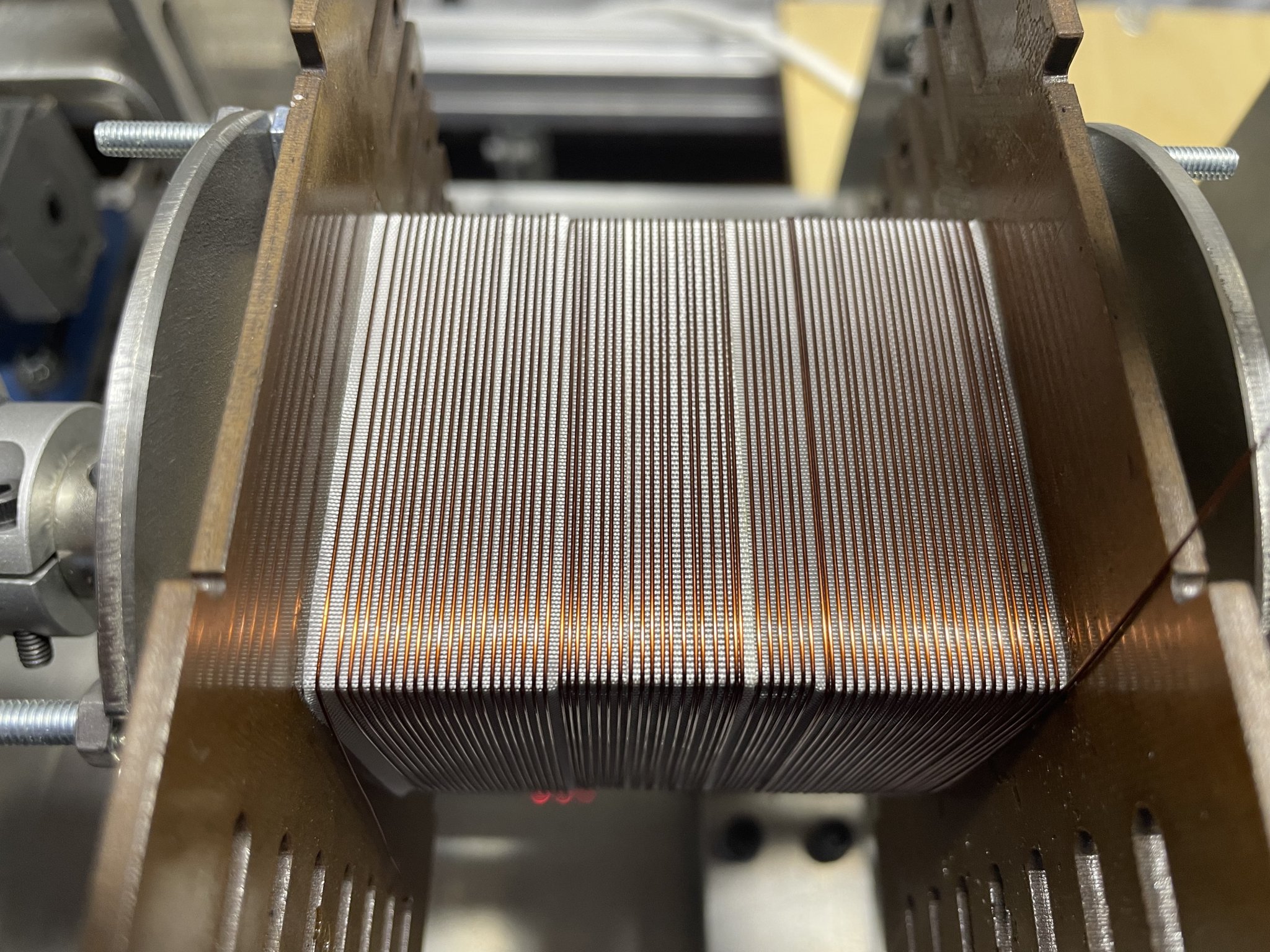

If winding won't fill the whole width of the bobbin there are several solution:
1) Even distribution (on photo 1).
2) Thin film-insulated (e.g. Nomex) flat (ribbon) litz wire (photo 2).

4) "Spiral" winding pattern with uneven distribution (mentioned by Emtor) have higher leakage inductance compared to the first 3.
