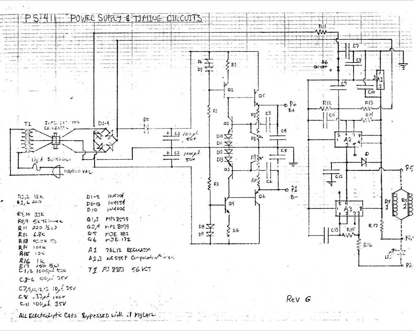

Hi. I am looking for the transformer specs for the outboard power supply brick of a PS Audio IVH preamp.
I bought the preamp for a ridiculously low price without the brick.
It attaches to the preamp with a 4 pin connector, but according to the schematic, only 3 are used, and the tranformer is a 56vct. No secondary voltages are listed.
It shows 4 diodes for the rectifier with what looks like 1N4501 (7v?).
So would it makes sense that the transformer may have a 28v secondary?

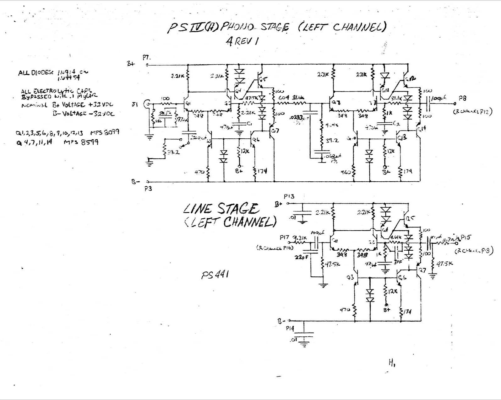

Schematic says the power transformer is 56VCT, and the regulated rails are +32VDC/-32VDC.
All the parts are listed, so you should be able to build it.
But the supply connector pinout is not given, so you'll have to reverse engineer that.
The rectifier and power circuit are contained within the preamp.
My problem is in knowing all of the specs of the transformer. A 32v secondary appears to be higher than the rectifier is specced for.
