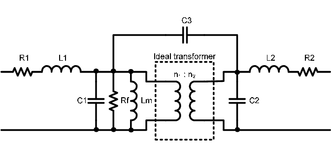

Also, here is an equivalent lumped model of a transformer:
As can be see there is more to it than the turns ratio of the ideal transformer shown in the middle. Lm is the mutual inductance, which results from the magnetic flux which is linked between the primary and secondary windings. L1 and L2 represent leakage inductance which results from magnetic flux which is not linked between the primary and secondary. Rf, shown in parallel with the primary winding, includes the effect of core losses in the iron core. R1 and R2 represent primary and secondary winding resistances. In particular, depending on which port you look into (measure from), impedances on the other side of the transformer appear stepped up or down in value according to the square of the turns ratio of the ideal transformer in the middle.

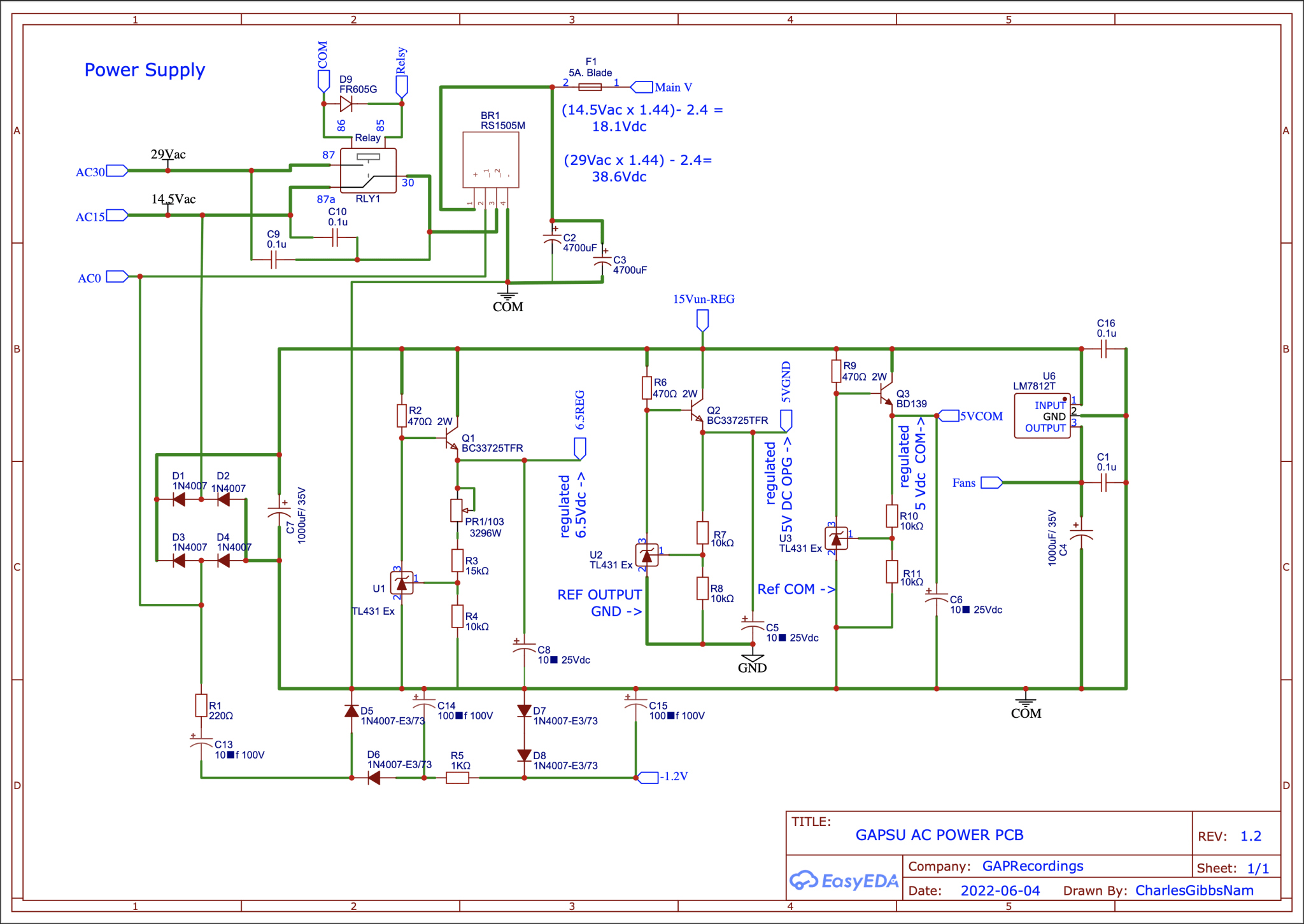

Today I have a different question, I have a built up a distribution PCB, schematic attached, this has a 15-0-15 transformer one part of the board has a dedicated sub voltage delivery and a main voltage delivery, when the first tap is selected everything works as intended, but, when the relay switches tap C7 goes bang. Only the ground on this schematic is "commend" this can only be because of back feeding voltage from the higher voltage tap, my question is: Why, how and can this be prevented with out having to use a separate transformer?
Would be nice if there is someone that could explain this please?
