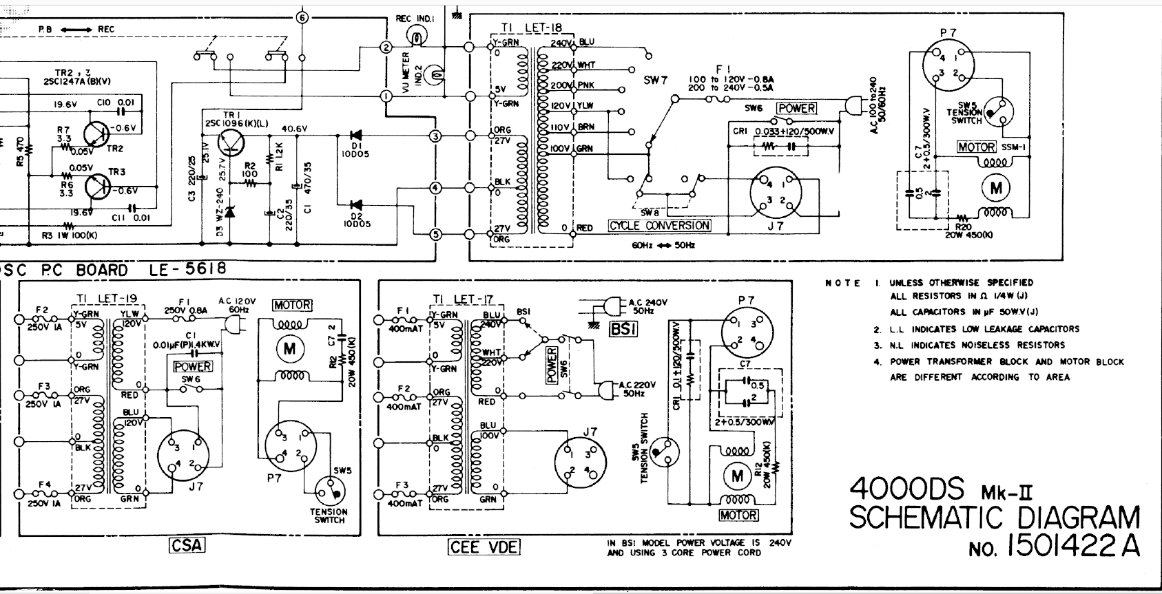

Look at the belt, the motor pulley, and the capstan flywheel.Yes, absolutely! This unit doesn't have a frontal knob to control the Hz input. It does say in the back it's a 120V 60Hz unit, but the motor itself runs at either 50/60Hz, so I guess the transformer (and other parts) swap compensates for that somehow? Maybe there's some adjustable switch inside of the unit I haven't seen yet. I will definitely explore this question further in the service manual, thanks for bringing my attention to it!
You WILL see there's TWO different diameters that the belt can run on.
One is for 60hz, the OTHER is for 50hz.

I got an akai 4000DSMKii
The original LET-18 transformer is down.
I found another LET-17 transformer.
According to the above schematic can I swap one another ?
Here is the mod list :
-remove wires from pin 3 and 4
-connect motor cap to pin 2 (2 pins)
-move tension switch between pin 1 and 2
-add CRI 0.1+120/300W.V (should I buy another one ?, mine is 0.033+120/300W.V)
-add a ground wire ?
Do you know what pulley diameter is for 60hz?Look at the belt, the motor pulley, and the capstan flywheel.
