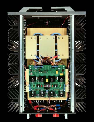

I think rectangular will look nice, attach pic of passlab x series, can't remember which model.
