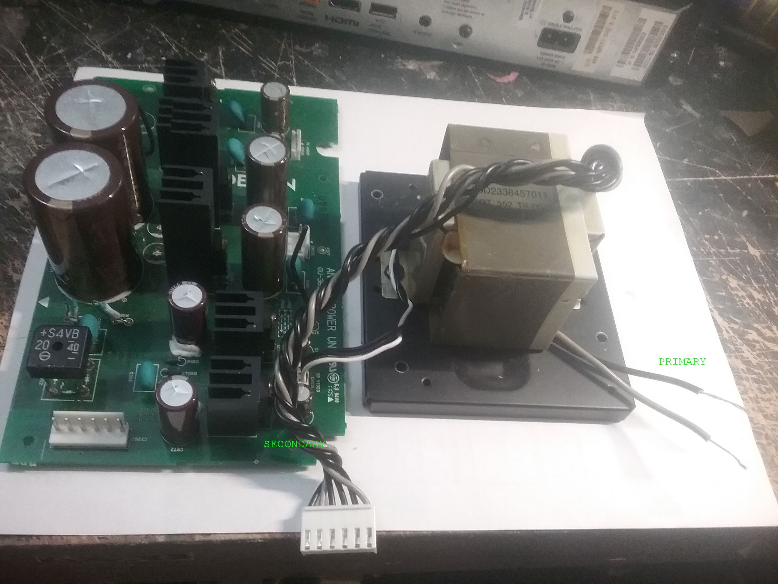

I salvaged this transformer and power supply from a Denon DVD player. Tonight I attached an electrical cord and plugged the transformer in and did not get any reading with my meter on the AC setting. As far as I can tell the grey and black wires in the photo are the primary and the 6 back and grey twisted wires are the secondary.
The transformer ID number is written on the top: D00 233 645 5701 1 with another number: GT 552 TK (Y) written below it. I spent 20 minutes scouring the NET for information on this transformer but no luck. Anyone know of a resource I missed for transformer I.D.?
Also am I correct in my assumptions about the input/output?
Thanks for any info.
Tony

Do you have the model number of the DVD player it was salvaged from? From that you may be able to find a service manual / schematic. OEM part numbers are often (deliberately) unhelpful.
Hi Tony,
I have salvaged a lot of transformers and even found some where I do not know the origin. I have a simple method I use to analyze a transformer:
I use my Ohm-meter for a start and try all combinations of wires to find out which wires are connected to which. The wire(s) with the highest DC impedance is normally the primary. "Normally" because if you recover the transformer from a particular use like the power transformer in a micro-wave, it has a higher secondary voltage than primary voltage. There may be more primary wires if it is meant for different input voltages. The primary windings are normally grouped together.
Then, I draw a small sketch of how the wires are connected to one another through the windings. If there is no DC impedance, you will have no useful output voltage (only a noise voltage without power).
Then the voltage test. I connect a 1A fuse in series with the primary and connect the primary side to the net (WATCH OUT FOR THE HIGH VOLTAGE ON THE PRIMARY SIDE! DANGER!).
I know from my sketch from which secondary wires I can expect an AC voltage. No DC connection - no AC voltage. DC connection and a good primary connection and you will have an AC voltage of some kind on the secondary, unless the wires are connected by a regular short-circuit. The voltages I measure I can add to my sketch.
The power capacity I estimate from the size and eventually information on the apparatus I got it from about maximum power consumption of the apparatus.

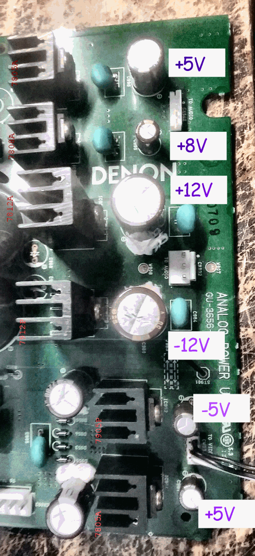

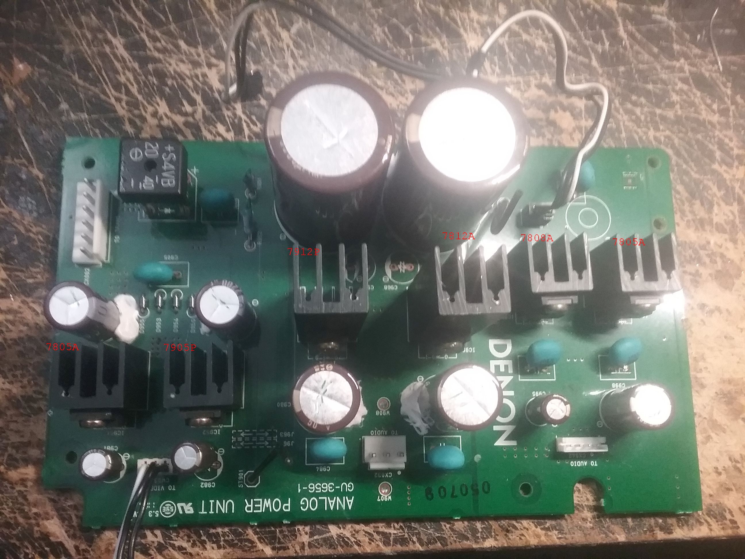

Thanks for all the replies guys. I have identified the regulators on the board an indicated them in the image attached. I am a rank amateur when it comes to this sort of thing so any and all help is appreciated.
Hi Tony,
Thanks for checking. Could you please list the type numbers from left to right in plain text? I have major problems reading the small red numbers on the photo.

From left to right: 7805A, 7905P, 7912P, 7812A, 7808A, 7805A
Many thanks, that is much better.
We have -12V, -5V, +5V, +8V and +12V output voltages. Using the -5V and the +8V outputs would give us 13V voltage. Using the -5V and the +12V outputs would give us 17V voltage.
It is likely some of these regulated outputs are common-ground and can not be aribtrarily put in series.
My interpretation is in the picture. +/-5V for DAC, +/-12V for opamps, and both +5V and +8V for CPU or lamps?

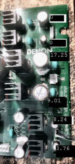

Thanks again for all the help. The photo attached is what I get when I measure the power supply, I have also attached the photo of PRR's interpretation for comparison.
I see that I have 3.76V and 8.24V on the far left 3 pin outlet which will make 12V but I don't know how to combine these (or other pins on the board) get the 12V out that I need.
