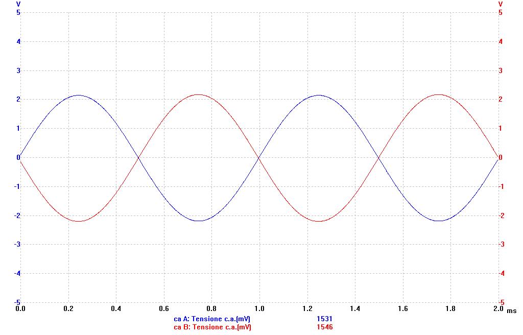

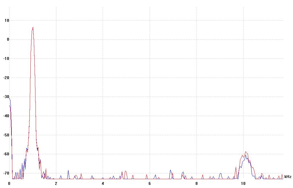

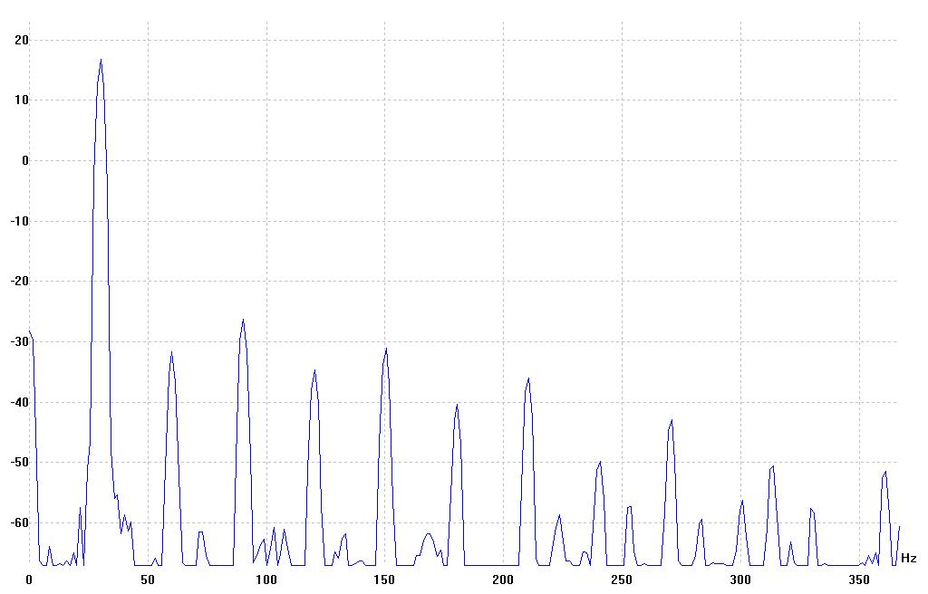

One of the best for thi purpose is Sowter 3575 with OCC wire.
In attach you can see two diagram.
One the input is 20 Vac in input / 1KHz.
the other is 30 Hz 5 Vac in.

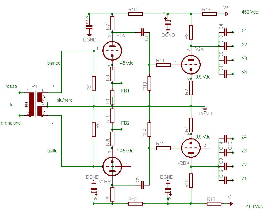

The last is a digram of two channels; the signals are the same.
The "ingresso" file is a schematic of a project of big amp ( 8 x EL34 /channel) developped for Audioreview magazine in Italy.
