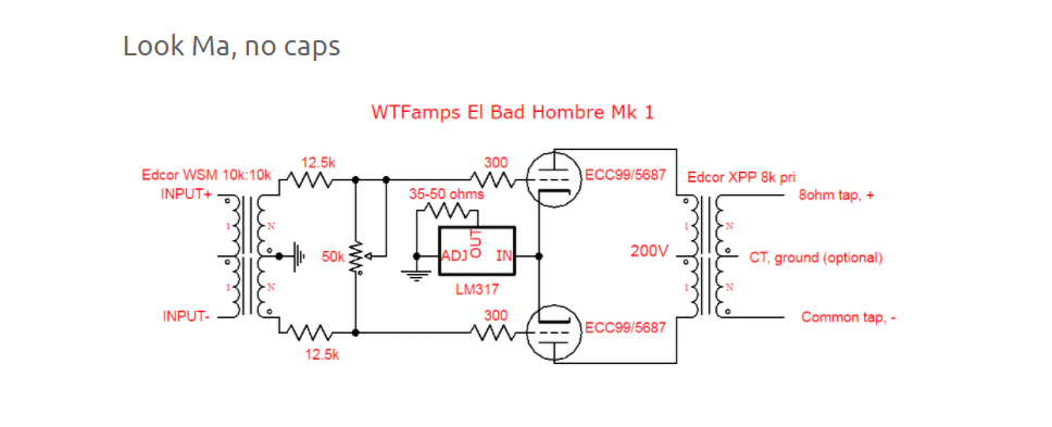

Come to think of it, if you haven't figured out your volume control yet then I would pursue the attached. Since you are determined to use an input transformer to address the RCA challenge (good choice) you are fully differential after. You don't need balanced attenuators - too much hardware. All you need is a single one in the right location. The 50k nodes referenced in the schematic is my single potentiometer (actually a Goldpoint).
This would be combined all into one right after your xfmr. If you need help drawing it out I can, but hopefully you get the idea.
XLR-balanced resistors-series resistors-pot-grids. Get it? The grids become a fully differential stage.
If you are truly differential, you need equal impedance for a balanced line, not equal signal.

I see, just shunt the whole thing PP? I've seen this setup across CT secondaries before as the volume control. Like this example too? (from another great diyaudio member site!):
A "Bad Hombre" is definitely on my to-do list, it looks like a fun little project!
El Bad Hombre “Balanced” Headphone Amplifier – wauwatosa tube factory
