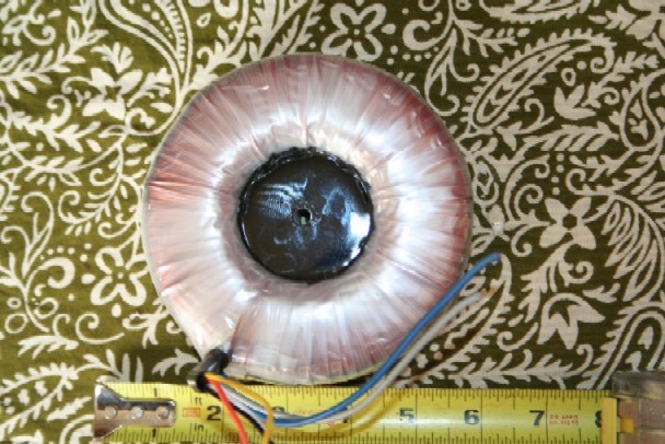

I bought a pair of surplus transformers custom manufactured by Toroid for a local company. The (custom)part number does not jive with the standard part numbering/ID scheme which would normally indicate primary/secondary configuration, secondary voltage and VA rating.
Hand-written labels on tape identified the units as 20V, 100VA and as they are equipped with single secondaries, I used a pair for my first IGC. Quite impressed with the performance and having a few more chips to play with, I returned to my "dealer" and carried 10 more units home @ $10 ea.🙂
I don't seem to have adequate power resistors on hand to properly test these things, but based on size/weight, I'm guessing that the units are indeed ~200VA.
Weight- ~5 lb
Dims- 1 3/8" x 5"
Does this sound about right to those in the know?

My rough rule of thumb for toroidals is 1 kilo per 100VA, so that looks about right to me. Good deal.
Thanks for confirming Pinkmouse!
I weighed them @ 4.5 lbs ea 😉
Having twice the power that I had counted on may well effect my project list...
Contradictory situation.
The label says 100VA, yet you want it to be 200VA.
I guess you won't know for sure until the fat lady sings.
Yeah, the fat lady is warming up...
The garage sale style labels and the physical dimensions appear to tell two separate stories. No worries though as my next two quickie projects are two channel GainClones which run happily on these trafos. I'll run a load test BEFORE I make any plans requiring more power

The rule of thumb i've heard is 20VA per pound for EI. Toroid is likely a bit higher, so that jives with the labels.

if they got the VA wrong, could they also have got the voltage wrong?
Measure the voltage before you connect smoothing caps and/or rectifiers.
Measure the assembled PSU before connecting the amplifiers.

planet10 said:The rule of thumb i've heard is 20VA per pound for EI. Toroid is likely a bit higher, so that jives with the labels.
dave
I've got a 300VA EI, it's certainly not 15 Lbs. More like 5 lBs. I've got 50VA EI's that that are less than a pound.
Thanks guys...
I called Toroid but the girl I spoke to couldn't find the specs for this custom part number as it is at least 3 years old. Testing to come.

126 Volt mains yield 23.6VAC(no-load), 30.6 VDC after rectifier/smoothing caps. I've had a pair of these running a 3875 Inverted GC for about 2 weeks. Cool and quiet.

MJL21193 said:I've got a 300VA EI, it's certainly not 15 Lbs. More like 5 lBs. I've got 50VA EI's that that are less than a pound.
300VA= 3Kilo x 2.2lbs = 6.6lbs. 😉
