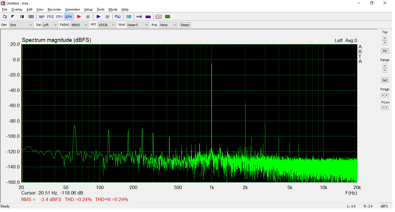

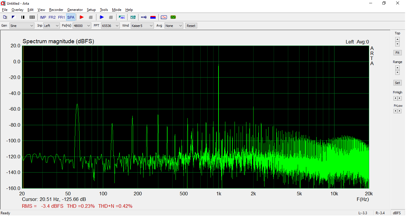

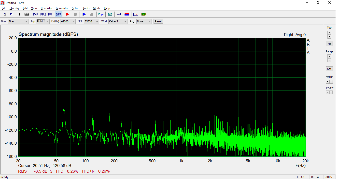

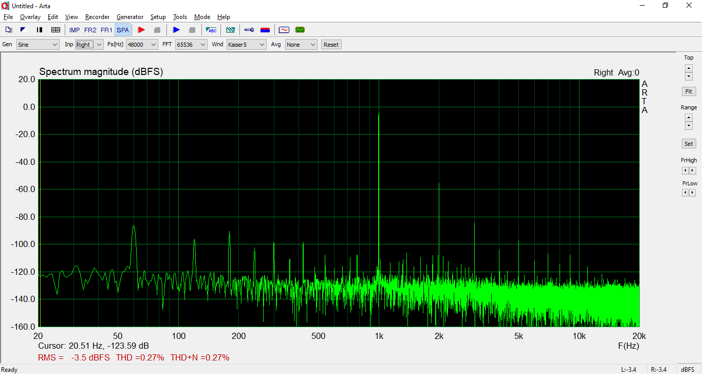

Here are some measurements.
First, the left and right channels with no cathode bypass caps. This is the situation in which the noise is clearly audible on one channel (the left in this case, since they windings were swapped), but the other channel is silent to the ear. I think you will see why in the plots.
Left:
Right:
Now here are the two channels with the cathodes bypassed.
Left:
Right:
As you can see, the noise pattern on the right channel is unchanged while the excessive noise on the left channel is now gone. There is still a 60Hz noise pattern with the cathodes bypassed, but you can see the pattern is now very similar across both channels and significantly attenuated to around -80dBFS.
I tried running one of the 6J5's heaters off my DC bench supply to see if the noise was related to heater-to-cathode leakage or the AC heater wiring, and that does not appear to be the case, there was no change.
I am wondering if this type of coupled noise is to be expected or if I should contact Sowter? Odd that it is only across one winding.
I welcome I thoughts or advice, thank you.
So one channel requires cathode bypass and the other doesn't? In the first two plots above, there is no noise on one channel without bypass while the other is at 120mVpp, -50dB. Why would it be asymmetrical?
Not trying to be snarky and I appreciate your help, just trying to understand the issue for future reference. According to Coleman, I should not be seeing 120mVpp out of the regulator. How would that noise be handled if I were using fixed bias?
If you were using fixed bias, you would have one end of the filament grounded. That's the problem, you don't have either end of the filament regulator at AC ground. The application notes show this as a likely necessity. This is also a problem for amp performance.
Okay, understood. In that case, I will leave the cathodes bypassed and move on. Was concerned that I was covering up an issue rather than addressing it. I suppose the -80dB noise is likely AC coupling within the amp. In any case, I can't hear it. Thanks again.
