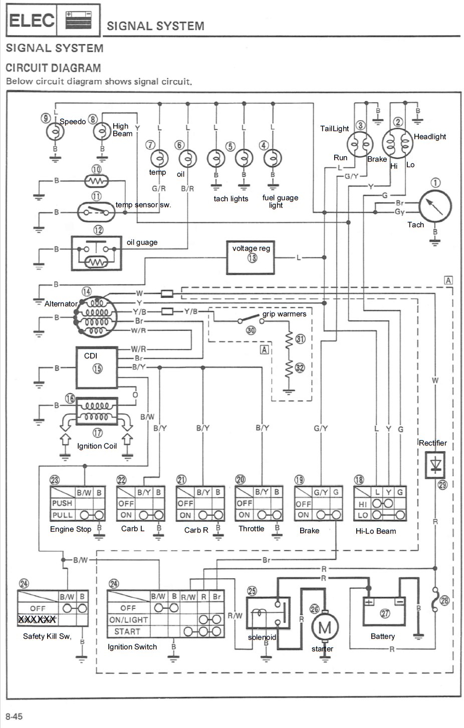

I managed to locate a wiring diagram. It's an old Yamaha snowmobile of a friend of mine.
It does have a battery but curiously the head and tail lights are off the coil but the brake is off the battery. The simplest solution would be to move the head and tail light to the battery as well? Not sure why the mfgr didn't do that. Maybe too much load with an incandescent bulb to keep the battery charged? Shouldn't be a problem with LED though.
Sorry for not posting in Everything Else.
Ok, well as I read that you likely have hybrid 6V and 12V electrical system. The center tap of the "big" coil on the alternator goes to battery, starter, and brake light and is presumably 6V, and the end tap goes to other lights and is presumably 12V. You should be able to verify this by checking if it's a 6V battery and if the original light bulbs are 12V. Take care figuring out what the brake light is.
If this is right, they your fix is likely just adding some capacitance to the 12V lighting circuit.
He sent me a pic of the battery and it's indeed12v. Not sure how i missed this because it's so obvious, but the lights aren't rectified at all, they're just regulated AC. Surprised the LED bulb worked at all but it explains why it was flickering.
I think the solution is to disconnect the wire marked L going to the voltage regulator and move it down to the Br connection on the ignition switch. Then all the lighting will be DC.
