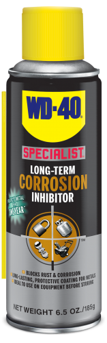

So I live near the ocean (Bay Area, CA) and have noticed how much quicker metal rusts in this saline environment. Transformer laminations and endbells are beginning to rust and pit. This is even true (though less so) for unused transformers stored in drawers.
So I’m looking for recommendations for ways of protecting these components from future corrosion. My best guess is to try applying a thin layer of a translucent dielectric grease with decent thermal conductivity (for power transformers). This is what I’ve found. I figure as dust deposits on the grease and begins to make it look dirty, I can simply wipe it off with a shop towel and reapply.

Thanks for the tip. Sounds like rust converter/neutralizer would be good to stop and prevent rust. The directions recommend also painting over it, which is fine for the output transformer laminations but I’m not sure power transformer laminations would appreciate it.
The end bells on my ST-70 are bare metal, polished. Perhaps I can just sand off the rust, repolish, and wipe them with dielectric grease. I also see WD-40 makes a sprayable corrosion inhibitor. That may be the ticket as well.
Just use barbecue paint or engine enamel if you want it colourful. My automotive experience with rust converter says you don't _NEED_ to paint it. No signs of rust after 2 years of salty winters. As well, IMHO paint isn't enough of a thermal insulator to raise the temperature much. I'm also 99% sure it's not an electrical conductor. The bell ends can be polished with any oil that won't smoke or catch fire (even turpentine will put a film on the metal). IMHO dielectric grease isn't necessary and will just make a mess.
Thanks for sharing your experience. There’s a surprising lack of information on this topic. The rust converter and WD-40 inhibitor are the way I will proceed in the future.

Personally, I like the smell of WD40... So what if it evaporates in months? Re-apply. Pennies a year. Rust converter will work better though. Funny, I was gonna say Kerosene or Diesel in my original reply.
Are you guys talking about run-of-the-mill WD-40 or this stuff:
The WD-40 was only being considered for the polished end bells, not the laminations.WD40 OR rust converter. Not both. 🙂
