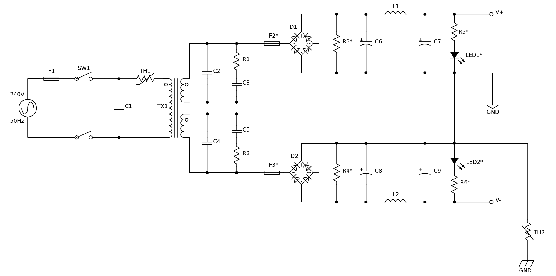

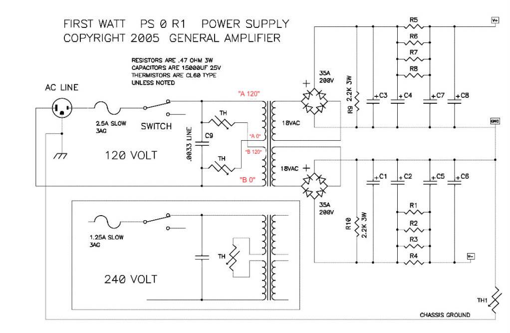

I'm configuring a new power supply for an upcoming First Watt clone build, and this time I'd like to experiment a little more with the power section. The plan is to forgo the use of the DIYaudio Universal PSU board and opt for large screw-terminal capacitors in a CLC filter.

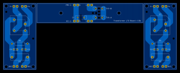

While trying to determine a suitable way to mount the rectifers and other components I wondered if I couldn't design a circuit board myself that would sit in-between the transformer and CLC filter. The PCB would mimic the function of the diode boards from the DIYAudio PCB, but instead use monolithic rectifer blocks and include additonal components not specified in the regular First Watt PSU design.
This is what I came up with:
The middle section is for 240V AC mains input with provision for one or two thermistors on the live wire for the regular FW-style of inrush current protection, then exits to the primary winding of the transformer. This version also places the 3300pF line filter cap on the board before the thermistors, however I wonder if that be better situated near the main power switch instead.
Flanking the AC input section are the two output sections for the secondary windings. They are designed to incorporate a snubber, plus space for a fuse holder if fusing the secondary is desired. The rectifier blocks are the GPBC-W type with the through-hole leads, hopefully with ample clearance around them for heatsink attachment.
The question: Is this viable, or just rubbish? Opinions or suggestions gratefully received.

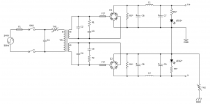

Original First Watt PSU, and preliminary new PSU design attached (*asterisks=optional).

Using two thermistors seems to mix the 120/240V versions. You may have a Live to Neutral clearance issue, 3mm. The same might exist Primary Live/Neutral to Secondary, 6mm.
https://www.electricalsafetyfirst.org.uk/media/1231/chargers.pdf
In NZ YMMV
Thanks for your notes. I was particularly concerned about the high voltage primary section. It may be worth dumping that portion altogether.
Although the First Watt PSU specifies one thermistor for 240V operation, some suggest using two in series. The board was designed to give that option.
It's the two in series that might have been causing clearance issues Live to Neutral. I would expect the component to be sized for the expected inrush versus steady state. I'm not going to guess at the required sums. Presumably two in series gives you a wider range of options and makes the sums harder. I would be inclined to use just one but with a multihole footprint for different sizes.
Having a mains portion on the board is not a bad idea as long as you take care of the clearances. It's nicer for the end user to have the means of mounting the required parts and if you get it right and give the required caveats then they don't have to worry.
You're right I expect. Using one thermistor instead would allow the L to N distance to be increased significantly, although it may be difficult to avoid using two long parallel traces.
I really should have included some measurements in the image. The board is 182x52mm, and the pads & traces are all 3mm. The clearance between the primary and secondaries is 7mm at minimum.
When looking at clearance, do we include the traces below the mask, or is it only the exposed parts to be concerned with? The Live & Neutral traces at the thermistor positions are only 1mm apart, but the exposed pads are much further.
My other concern was whether 3mm traces (at say 2oz) would be enough to handle the current requirements of the amplifier.

Also, traces carrying 240V (340V peak) require 2.31mm clearance, so the input section traces will have to be adjusted.
Generally a solder mask cannot be used to reduce creepage/clearance distances. It's purpose is just to prevent wetting of otherwise exposed tracks and is subject to damage and poor application. In order to impact creepage/clearance distances you would need to specify a conformal coating which is a different and more expensive beast.

I think if I want to employ large trace widths, and observe safe clearances for the 240V line, it would be best if I split the high voltage and rectifier sections onto separate boards.

It's been a while, but I've still been working on this.
The size of the planned CLC filter section has altered the shape of this PCB significantly, but with some pleasing results.
I've redesigned it to wrap around a vertically mounted transformer, which has enabled the high and low voltage portions to be separated by some distance. Although the board traces are now a meaty 8mm, clearances are still relatively substantial. I'm considering moving some of the traces to the bottom of the board to increase clearances also.
Yes, the Mains input and Tx Primary connections are facing the wrong way. This is to give more room for maneuvering the transformer primary wiring.

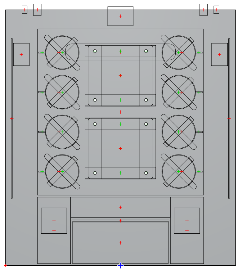

Below is a larger version of the PCB layout, and an early mockup of the chassis internals showing how it might fit together. The very large dimensions of the CLC filter being due to 8x 50mm caps and 2x rather monstrous Hammond inductors.
Once again, any input gratefully received.
