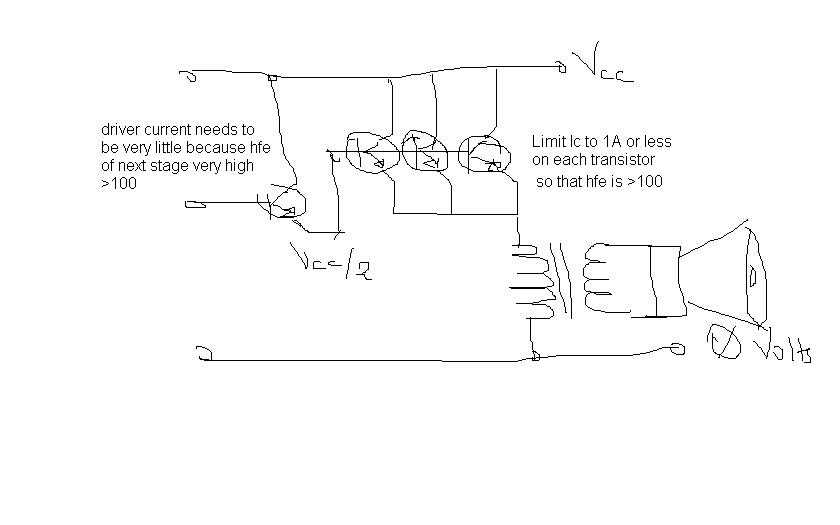

Hi Akis
You've had some good advice here. Your speaker shouldn't see the DC. your transformer circuit won't work as it is.
A good transformer design is not easy to build. You could build a class A with a single transformer output, but large transformers (taking 3A or so static current) have high leakage inductance (stray inductance) that can ruin the high frequency response. Sowters have a range of transformers for valves and I'm sure they'd make a good job of building one suitable for transistors, with as low a leakage inductance as practicable. (They make one I think for Susan Parker's amp).
If you match the impedances (and design for 8 ohm pri/sec) then life might be easier - you could use the same wire gauge for pri/sec, and each layer of turns could be alternated pri/sec, and the difficulty of wires not fitting over different gauges is eliminated. But interwinding capacitance may still wreck the high frequency response....
cheers
