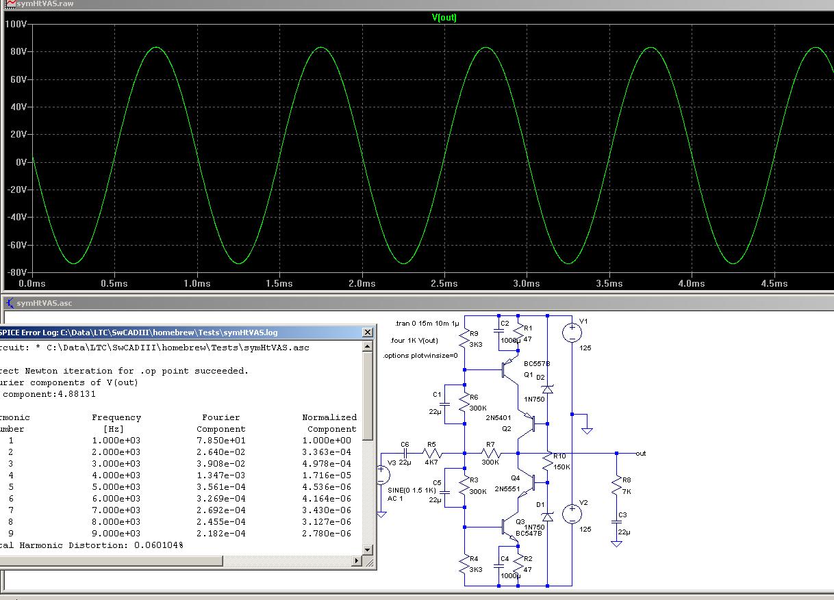

Using cascode techniques, achieving a reasonably low THD is not difficult.
Here is a quick example yielding 0.06% THD on the stated load (is much lower unloaded).
Getting comparable results from a transformer would be near impossible, even with ferrite.
And I am not even mentionning the frequency response issues.
The circuit is unelegant with coupling caps, etc but it's just an example, and you can easily clean it up.
Using a ferrite transformer of 1cm² core area, you would need about 35000 turns to obtain a response to 20Hz without exceeding an induction of 0.2T (which is far from small signal).

Thanks for the tips. I have so far been avoiding using more than 1 active device per stage and the cascode circuits use more than 1🙂 However, I am now toying with a simple cascode circuit, it seems we are using more than one transistors in series to share the voltage whilst using small signal transistors that have very high hfe. I am playing with 4 NPNs chained together over 160 Volts on SPICE. I am trying to divide the voltage drops equally amongst the 4, I have not read any documents on how to do this, just experimenting and see how it goes. I have got it to yield less than 0.01 % with x10 and at 12 V rms. I cannot go to 40+ V rms without incurring a 0.2% THD, so I am experimenting more. I sort of understand my circuit but I cannot say that I even begin to understand yours 🙂 The trouble is my circuit is very volatile, very sensitive to small biasing changes, according to the simulation at least. I hope the simulation is accurate and am not wasting my time.

You don't need to put multiple devices in series, you can easily find devices with 300V Vce. But, in order to reduce distorsion, you need the cascode configuration. 5V across the lower device is more than sufficient.
And if you want meaningful simulation results, you have to include the load; results will be quite different.
And you also need to simulate your output buffer with a source impedance matching that of the voltage amplifier. Results will significantly differ too, from a zero ohm source.

Why do you say that cascode reduces distortion? Is it because each transistor will "see" a smaller Vce over the same output voltage swing?
No, it is simply because the pilot transistor sees no delta-Vce.
A single-ended alternative is also possible, and takes you below 0.01%:

Hi, I ran your latest circuit into my Sim and got 0.006%.
However, without wishing to sound awkward, your circuit has an very big gain stage followed by an output buffer and a negative feedback loop to tame distortion.
But my original premise was to avoid exactly that, the negative feedback, as well as avoid having multiple transistors on the same stage, eg cascode or regulated voltage sources, current mirrors, constant current sources etc.
So I looked at the possibility of a transformer to do the 1:60 but I am told this is almost impossible. Then we looked at cascode to be able to use BC548s with 150V supply rails because those have higher hfe than high voltage transistors and also because of "delta-Vce" (what does that mean ?).
I have come up with very simple cascode circuits using BC548 with 160V rails and am still experimenting (on simulation). I can get down to 0.009% so far, but not on a 7K load. Still trying to understand how it works.
