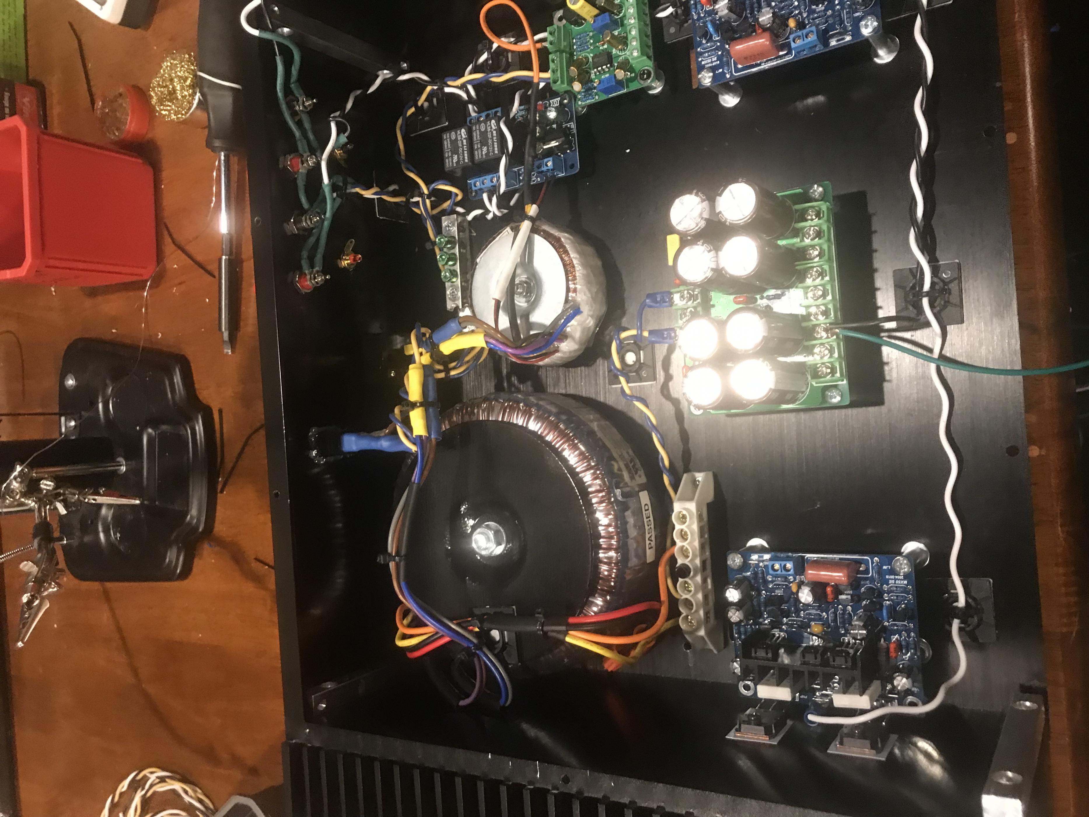

Thank u so much yes that was extremely helpful once I learn how I will load some pics of my build
That looks great, should be a nice setup.
Just double, triple check each connection one wire at a time before you power anything up.
Also I would install some fuses starting with one on the A/C, before the transformer, and four more, one on each power wire to the two boards.
There is a very handy device made from a screw-in incandescent light bulb fixture, 60w incandescent bulb, standard plug/wire. By inserting the bulb filament in series with the A/C, you create a softer connection that will indicate if there is a problem by illuminating the bulb.
Usually the bulb surges bright for a second or two, then dims down as the capacitors are charged. If there is a problem, the bulb will become very bright immediately and stay bright, and with one hand on the plug, can be quickly de-energized. This is less of a hard start than a straight wire, is highly recommended to avoid smoked parts.
