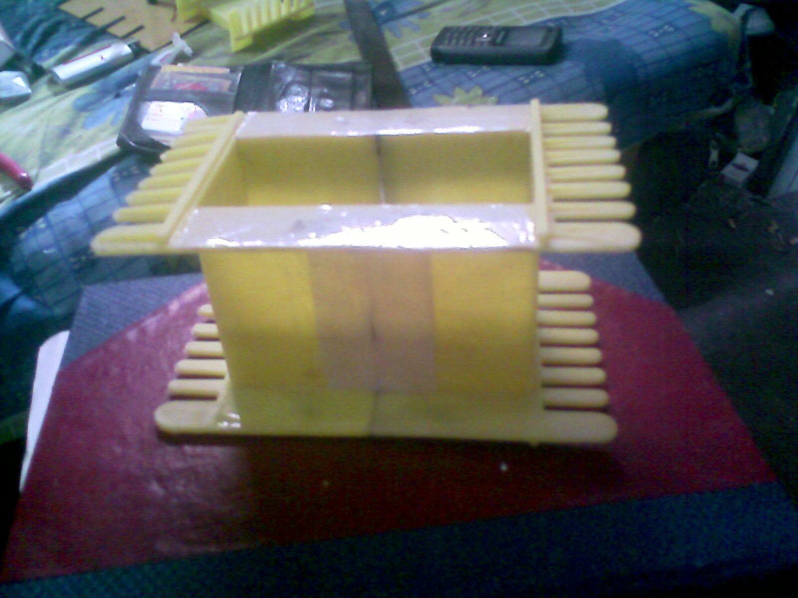

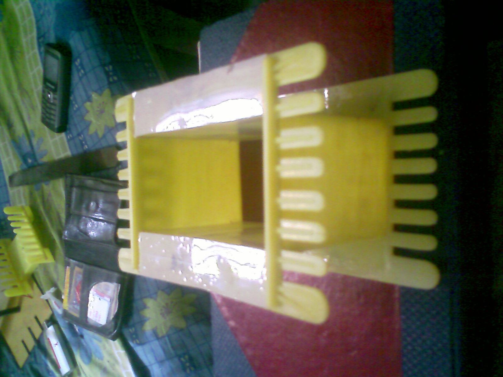

picture of my custom made bobin
i would like to suggest that you use wood mandrel to hold those coil formers.....a rubber mallet will come handy to fix up the bulge in the windings...you can also use a table vise to take care of the bulge....
