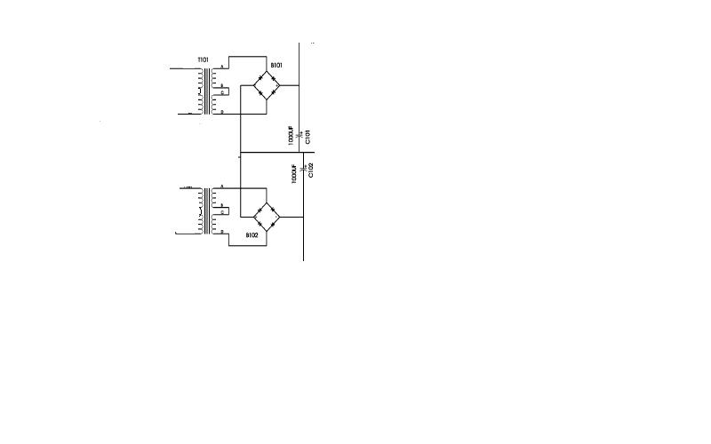

Looks different.... Shouldnt you connect your "virtual center taps" from the Toroids to the Gnd instead of creating a Quad like gnd from the main caps?
basically the "D" of Toroid 1 will be connected to the "A" of Toroid 2 to make your center tap or gnd....

Trannies OK, bridges wrong
The transformer wiring looks ok to me (as long as you really are planning to use two bridge rectifires, not one) , but I think you have the bridge rectifiers wired incorretly.
The negative of the top bridge should connect to the positive of the bottom bridge.....

Oh yes, negative of top bridge connected to positive of the bottom one.
How much VA I should get if each one has 350VA?

kon_udorn said:How much VA I should get if each one has 350VA?
You will have the equivalent of one 700VA 50-0-50 transformer..
