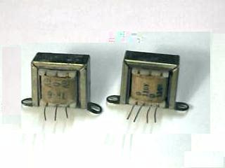

I was wondering if you could use a transformer without a center tap for an esl by using something like 32 1 megaohm resistors in series connected to the primaries and connecting the HV supply between the 16th and 17th resistor and the membrane.
Also I was wondering how these small 1,5 VA transformers would work when using 10 of them, connecting all the primaries in parallel and all the secondaries in series, their frequency response could be very bad, but at 60 cents a piece it might be worth a shot.

You could make a virtual center tap between the 5th and 6th transformer secondary.

Absolutely bad.Cheap trannies will have low inductance(will load your amp heavily), poor frequency response, and high levels of distortion.
Mains toroids for 12V lamps are a much better solution.

Won't those toroids saturate heavily when driven above their rated voltage?
I can get 50 VA 2x 15 volt toroids for 8 euro a piece, these will be a better solution.

Small trannies saturate much quicker than large ones.The larger, the better... It is recommended to put a small value resistor ~0.5 ohm at amp's output. ESL to amp looks like a large cap , so resistor can prevent oscillation , which could destroy output transistors.
A simple amp for driving ESL can be built from LM3886 , as it is easy to build , and is very hard to destruct.

I might have a better option, 60 VA 100 volt line transformers from amplimo, I have sent them an email about what turn ratio they have but I have received no reply as of yet.

beeing power trannies, the toroids don´t saturate that easily. As standard trannies they are usable for mid-high-frequencies only -no fullrange mode- which reduces saturation probs further. a pair of 50VA types is sufficient to even drive big high capacitance panels. The voltage rating of the insulation is quite high and can be improved further by vacuum dipping with a varnish.

Line transformers may have even lower turns ratio then mains toroids.I don't know about amplimos line trannies.You should ask for more parameters , like frequency response ,etc.
I have tried one 250W 220V/12V main toroid at 20 volts input(Reversed).The output was somewhere near 400V , and THD @ 1 khz was around 0.1% .Interestingly , THD rose with input voltage, probably due to increasing core saturation.
Frequency response went up to 20 kHz and more.Lower limit at this voltage was ~100-150Hz.
The transformer also produced quite much of sound itself 🙂)

Simple math:
If the input voltage is 100V , output Z = 4 ohms , P = 60W.
So, Vout=60/4=15 volts.
Turns ratio is 100/15 = 6.6
Not so good.
if P is lower , output V is lower too , and turns ratio is higher.

There is something wrong with your math, 60 watts into 4 ohms is (60*4)^0.5 = 15.5 volts, very close in this case but this is the right calculation.
