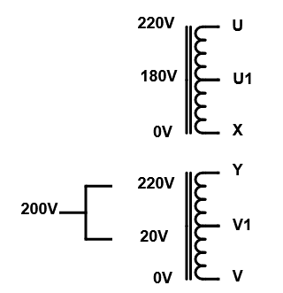

If I understand correctly, this is the primary winding diagram:
Connect U to Y, and connect V to X will paralleled both primary windings for 220V input.
Jawohl, I think you are right. That way you connect the two windings in parallel. U1 and V1 stay unconnected in this case.I am not 100% if is correct, but I think that I must connect 230 volt to U and V and make bridges from V to X and/or U to Y? Maybe someone German speaking can help me.
Correct. I am wondering if one can use it wired for 240V (for 230…240V mains) when load is moderate.
That would be 230V on U and V, Brücke on X-V1.
Or 230V on U and V1, Brücke on U1-Y. 180V open primary winding.
Some doubt on the either 180 or 200V open primary winding.
Huh? That would be 230V on U and V, Brücke on X-V1.
U -- V, bridged X-V1 yields 240V. U-V1 and bridged U1-Y yields 240V.

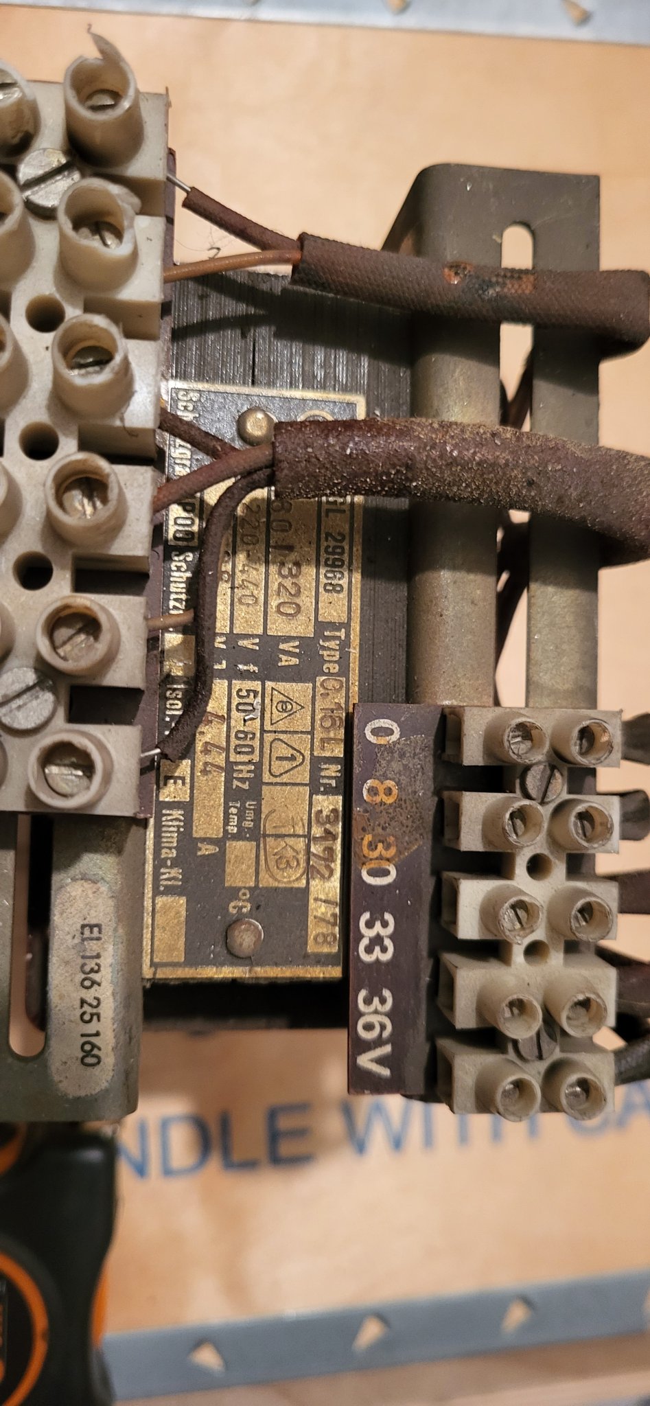

Connecting 235V to U and V Bridge V-X and U-Y it works.
With a 100W bulb, it runs 150mA, and the output voltage is defined. Without the bulb, directly connected to 230VAC it runs 250mA in standby. The output voltage is around 13% higher than defined.
There is also very little mechanical noise present.
Of course it works when it is not broken but it would also work when using the 440V windings on 230V mains 🙂 In fact it would work on all the noted voltages and so the secondary output voltage can be "adjusted". The question is if the humming becomes less when using the suggested 240V primaries. The output voltage will be more according specifications too.
I think you have an imprecise power meter as 57.5W without load (if that is "standby") is a lot. If the values are correct that would tell me to replace it ASAP for a new transformer wound for 230V. If I need a custom transformer I have them wound for 240V even.
The amperage was measured with my fluke dmm. I think I will try to rewind this transfomer. It will be for experiments.
Most of it is not real power, it is the magnetizing current (~57.5VAR).I think you have an imprecise power meter as 57.5W without load (if that is "standby") is a lot
Depending on the transformer's VA, it could be normal or high. Some construction types result in a higher magnetizing current
