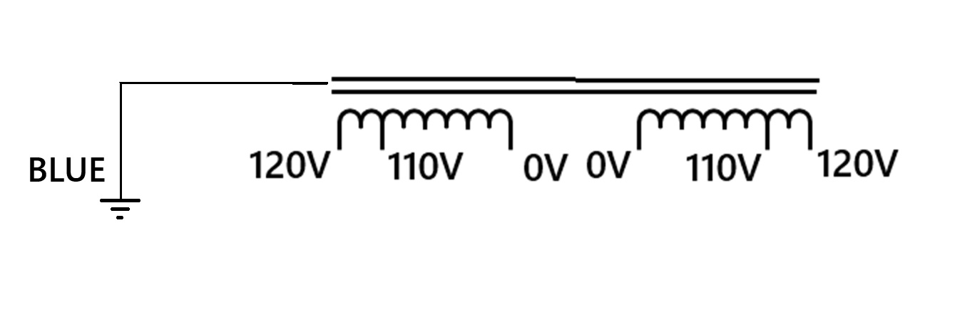

I'm guessing there are two primary windings with taps, in parallel will be 110V and 120V, in series will be 220V and 240V. The question is which wire belongs to which winding.
