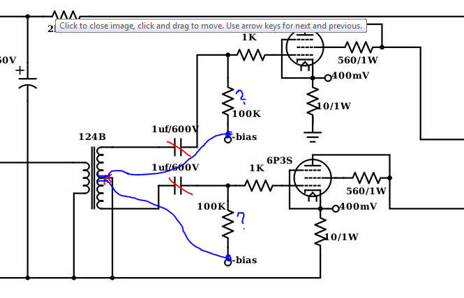

So, by having the input going to pin 1, p2 to ? . on the secondary the p3 to one tube and p4 to ? then p5 to the other tube. Or both outputs to 2 different sections of a dual triode. You don't happen to know of a schematic of an amp where this type of IT is used as an input splitter.
This is what I would try
Primary
Pin 1 in hot
Pin 2 ground
Secondary
Pin 6 upper triode grid
pin 8 lower triode grid
pin 7 ground or bias voltage
If it is noisy try lifting pin 7 and use 47K resistors from each grid to ground or bias voltage.

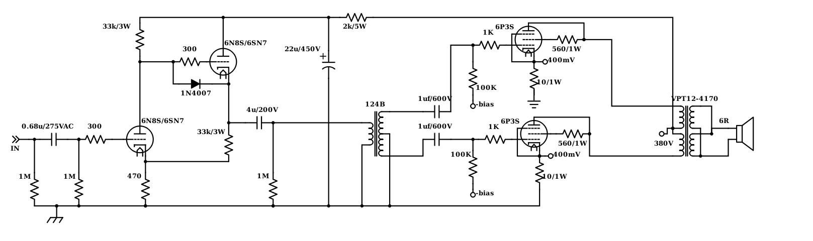

mosfet source follower for input, transformer as phase splitter, 12AU7 or 6SN7 as drivers for output tubes.
What is the purpose of this? The topologies of the 1930-s have seldom been improved upon soundwise. No idea why you need those mosfets to drive the phasesplitter. If primary inductance is insufficient choose low Rp tubes, or just a decent transformer. 6SN7 is probably a reasonable driver for pentodes but i will never consider driving DHTs with it. And why waste all the wonderful opportunities a transformer offers when driving output tubes directly?
If you worry about the UTC O-6's low impedance of the primary being hard to drive at the input, then just use it in reverse so you have 95K at the input and secondary becomes 15K. Use two matching 7.5K resistors tied to ground and, voila, you have yourself a very balanced phase splitter. Of course, you will lose some gain this way, about 2.5 times step down but that's not too bad. Just use higher gain tubes at the input stage.

Thanks DirectDriver. I am not trying to build a finished amplifier. This is a learning exercise. I will probably try what you described also.
But, I am not interested in throwing away the gain and want to use low mu tubes as drivers.
When I suggested a source follower before the transformer it was in reference to Eli Duttman's post. Though I don't know if what I described is what he meant. Hence, my asking the question.
I have several preamps. Two of them use cathode followers for outputs. But, I am not taking these out of service. The others do not and would be the input for this experiment.
I was assuming you have a two stage driver, input tube and driver tube. Most people use a high gain tube at the input anyway. If don't want to lose gain, then a line level 1:1 ratio bridging transformer will work well for you and they're not that expensive, certainly cheaper than interstage transformers!
