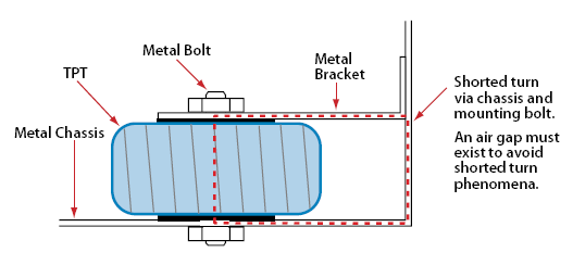

I'm actually not comfortable running the system.
All the voltages check good, but they are HOT!
My infrared meter pointed at the windings reads 60c at idle.I tried disconnecting the secondaries and same results. My primaries are parallel 115vac. Even tried single primaries. You can actually feel them vibrating as well. Either and both. Never had this issue with even my 1500va plitron or the 750va.
May have to special order
Thoughts on the best manufacturers?
Apparently I'm dealing with a shorted turn..
I've got the mounting bolts grounded in 2 places similar like this diagram..
Confirmed
It was too hot to touch, now she's cool and quiet.
I wonder how many amps were cruising through the chassis �� then. Lol. Initially I had planned to mount to just one side, but a change of plans had me tap the faceplate as well. Now it's just the faceplate. New knowledge.
