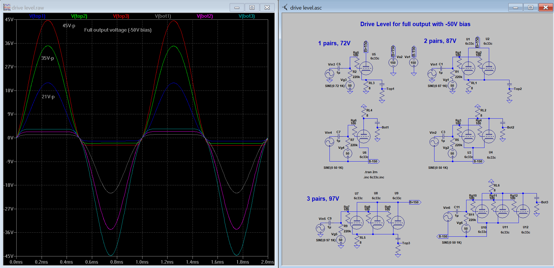

The existing driver should be able to drive extra pairs, and only need about 100V-p to drive 3 pairs of 6c33c to full output @-50V bias
I don't know what you mean by existing driver? I use a split load and in order to get high enough voltage for 4 tubes fed by 175V, (175V is needed to get 80W from four 6C33C) my choice was to reduce current in the split load thereby increasing swing and to add cathode followers DC coupled to the 6C33C grids. I see that you have 220k as grid leak for the 6C33Cs, that is on the limit, less than 100k is better from my experience. 6C33C start to draw grid current when close to 0V so if you want to drive it to that point you need to provide some drive current.

The gain of 4 pairs 6c33c is 1.4, not much more drive is required than 3 pairs, as it needs only 100 V-p drive level, this would give you over 100 watts (45V-p, 31V rms) into 8 ohms, you need only 150V power supply as the sim shows, is there something wrong here in the sim, the kink you mentioned does it matter here?
The existing driver in the amps mentioned in the earlier post such as Tim Mellow can handle that. However if the bottom tubes gain is intentionally reduced (by mean of NFB for instant) , it then required more drive level to get the same output as if gain were un-attenuated.
Yes, maybe but I get 80W with 2 pairs! I can get 100W but I use equalising resistors in the anodes to even out differences between tubes, this reduce output power. In order to use 4 pairs, (8 tubes) you would need to match them very closely or to use large equalising resistors or it would not work. I think it is better and easier to use fewer tubes with a bit higher anode voltage, (higher anode voltage is needed to cater for the increased output voltage) and modify the driver for more drive voltage, (grid bias is higher due to higher anode voltage).

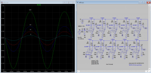

I have never found a spice model for 6C33C that is good enough for much more than idle conditions, the best I found was from an organisation in France, Exceem, they also included the kink and verified the model all true the anode voltage range but not for higher currents than 1A, (of course there will be large differences between tube samples, these differences are not shown in the model). The kink affects distortion and bias conditions, a simple model gives either wrong bias or wrong current for small currents.

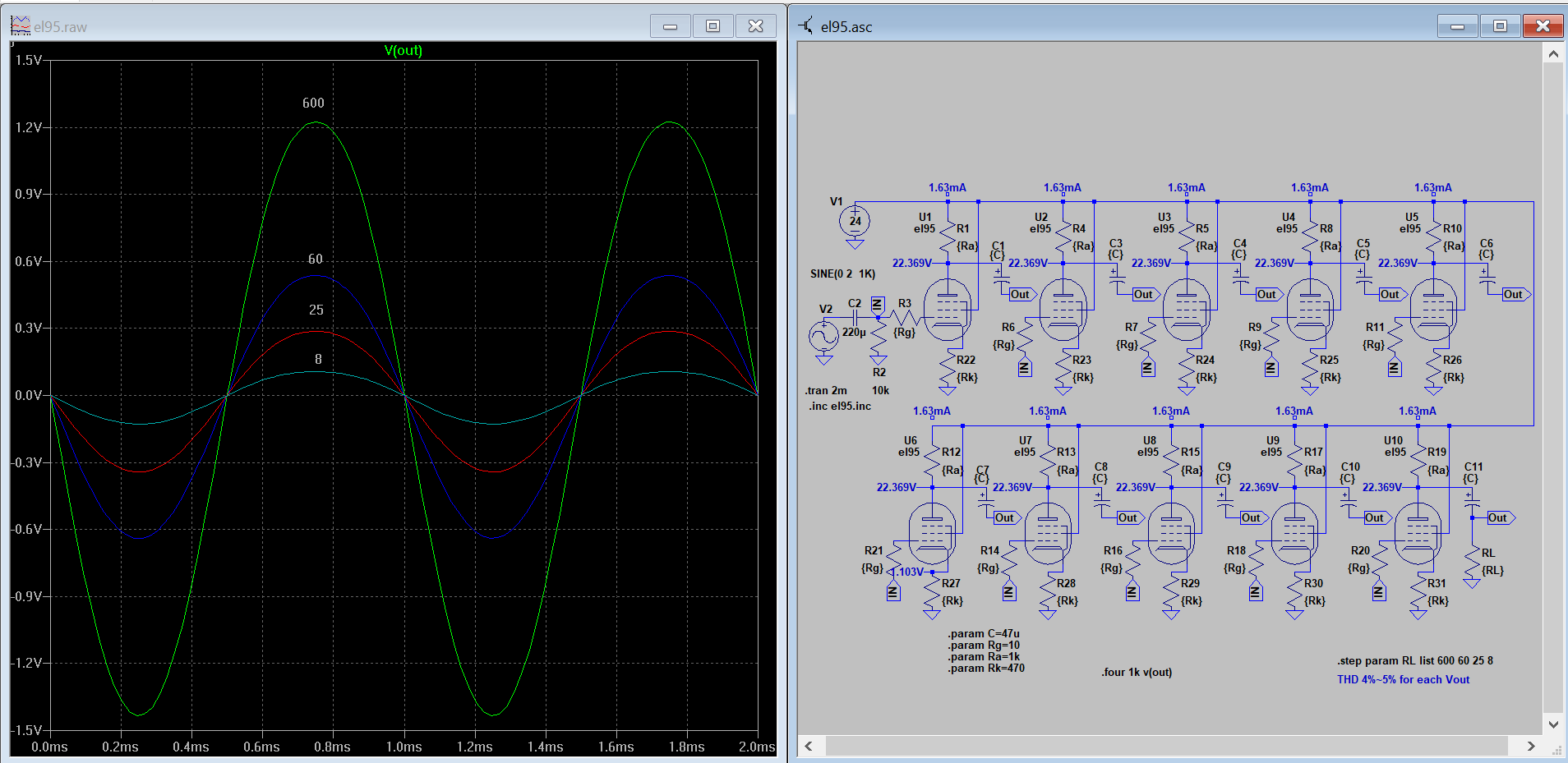

...parallel more than one PL504 to reduce the output impedance so as to be closer to 8 ohms? ...does each tube need to have its own resistors or just parallel them pin by pin?...
Yes. Here is 60 Ohms. Heck of a headphone amp even for modern low-Z phones. 8 Ohm loading suggests 75 PL504s, will make around 0.9 Watts, while eating 560 Watts of 24V power. Per channel!!
BTW, this type resistance-coupled "power" amplifier *sucks*. A choke-loaded power amp can approach 50% efficiency, push-pull can go toward 78% eff. A resistor-loaded amp's best efficiency is a bit over 8.5% MAX. For ideal devices! Using tubes, 4% plate circuit efficiency is fantastically good; counting heater power also the efficiency is about 0.26%.
