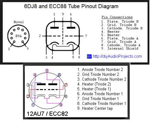

Escentialy, the heater. 12AU7 uses 4 and 5, and 9. ECC88 has at pin 9, an internal shield to be grounded. That isn't a problem. The true problem is that ECC89 almost quadruply the gm of 12AU7 (about 3mS vs 12mS, then you must re-bias the set too.

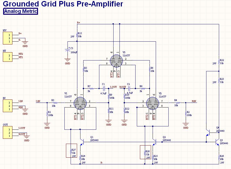

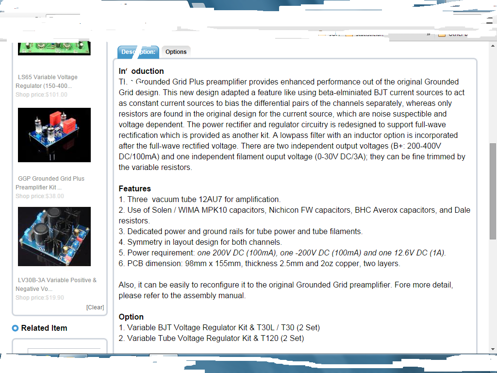

Actually Analogmetric has offered a kit with slight modification based on the Transcendent Sound Grounded Grid, and it states very clear about all parameters on their website.
The power requirement is 200v@100ma, so 0.15A is pretty safe.

If that schematic is close to the Transc then the current is only 7mA at 2x 200volts (a plus and a minus 200v).
Changing the 12AU7 by other tubes will upset the hole DC situation and is very bad for the headroom for the AC signals.

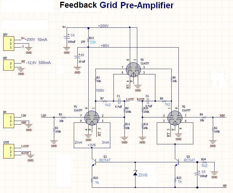

Mona
Keep it simple, rectify the 225volts (1fase positive, 1 negative or 2fase if you use two 225volts windings), gives round 300volts DC (+ and -) on a pair of electrolytics (~47µF).After that 10k (3W) for a drop of 100volts at 10mA, 7mA for the amp and 3mA for a zener shunt (take two zeners 100volts in series).On the amp decoupling C's if not allready there.
Negative side is a mirror of this.

Strange that the 'improved' kit uses branded resistors, yet fails to reduce the values of R9-12 in order to reduce thermal noise. Maybe they didn't think it was worth doing as R3 and R4 are large too.
With a gain of 6x it is probably not intended for weak signals.
And if you make R9-12 smaller the load resistance can't go less low.
In the meantime I amused myself by drawing a simpler version without the -200volts and some more current 😀.
Mona
