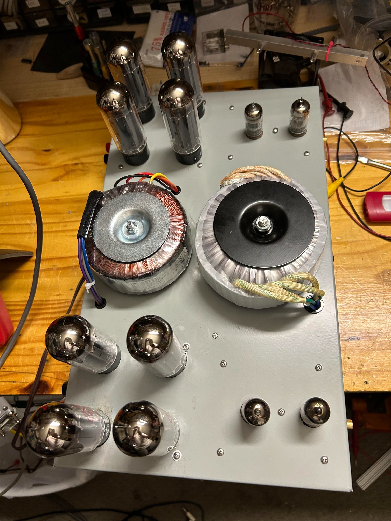

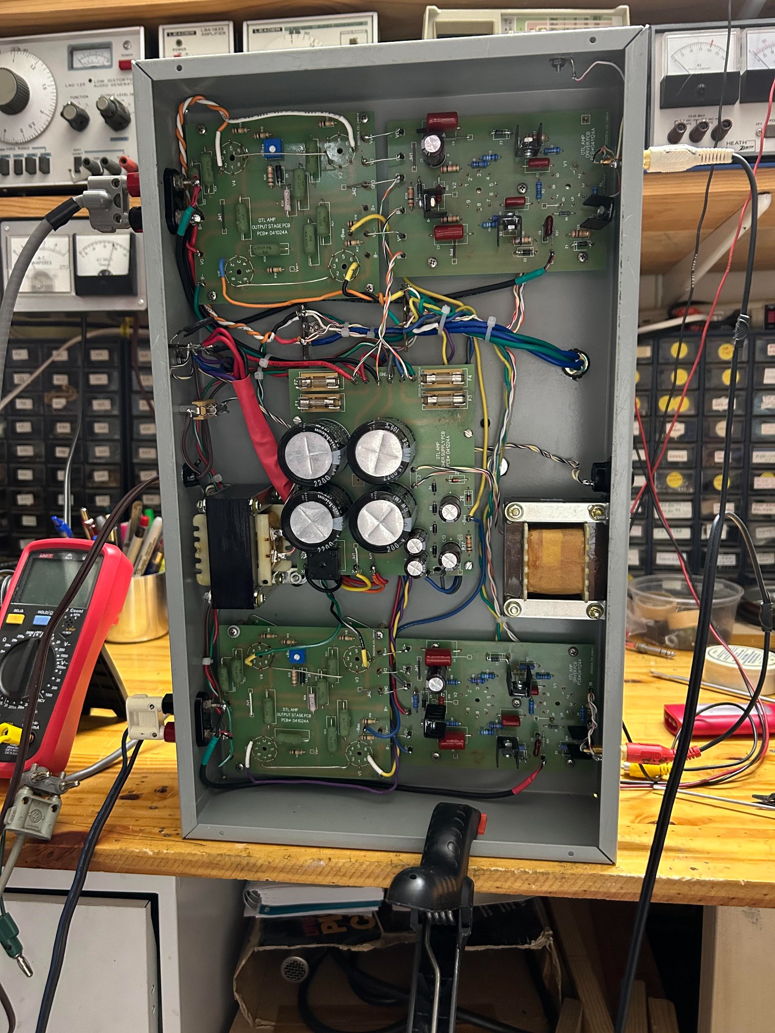

Send an email to Bruce and ask him. I am currently building a Beast Jr. Back in May I built the Son of the Beast from scratch using his book (Tubes and Circuits)and its sounds really good.
Art
