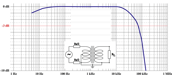

I've tested Toroidy TTG-KT88PP (4K Ohm 80 Watt P-P ) and TTG EL34PP (6.6K Ohm 50/60 Watt P-P ) OTs for low freq. performance using a Variac source (across the 8 Ohm sec), current probe and scope. The TTG-KT88PP shows significant current spiking at 46.6V and loud buzzing at 55V 60 Hz.
47V at 60 Hz would work out to 80 Watts at 32.3 Hz.
The TTG-EL34PP shows the same significant current spiking at 37V ( 8 Ohm 60 Hz ) and loud buzzing at 44V.
37V would work out to 28 Hz at 50 Watts, or 30.5 Hz at 60 Watts. (the datasheet calls it 50 Watt but the actual OT has 60 W marked on it )
I tested an Edcor CXPP60-MS-4.2K OT also, to compare with. It shows the same level of current spiking at 53V 60 HZ ( on the 8 Ohm sec ), which would be 60 Watt at 24.8 Hz.
I plan to buy a Toroidy TTG-CFB4000PP ( 80 Watt 4000 Ohm CFB P-P OT ) soon, so I will test that too. These three Toroidy OT's all have the same core size, so you can compute the relative turns used on them from the primary inductance data. TTG-KT88 says 427H, TTG-EL34PP says 591H, and TTG-CFB4000P says 580H. The 1st two do check out with the measurements, so that would work out to 54.77 V at 60 Hz for similar current spiking on the CFB model. So 27.7 Hz at 80 Watt.
This all goes to show than one should get maybe a 20% bigger OT (Watts) if you don't want noticeable magnetizing current (spikes) distortion at the low freq. end at full power.
The other higher Zpri CFB models show the same primary inductance, which concerns me, since the secondary would have to have fewer turns to get the higher stated impedance ratios to 8 Ohms. That would mean lower secondary voltage tolerance and Watts than they are spec'd at, at least for a 30 Hz bottom end..
