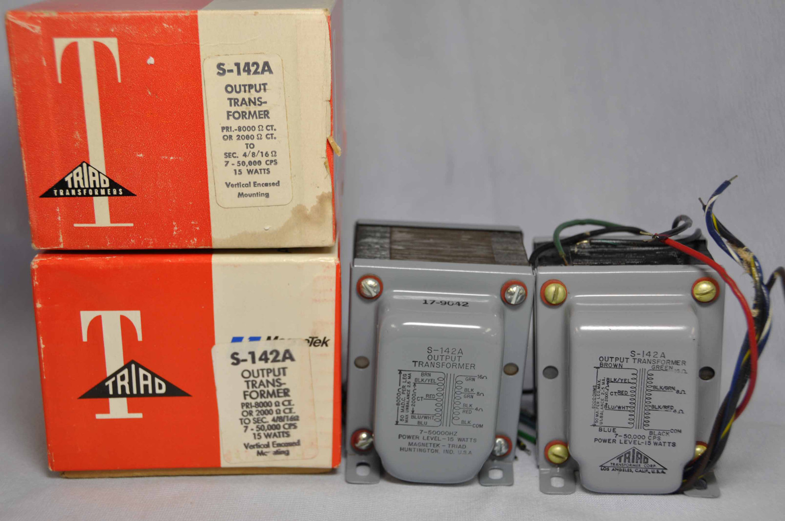

Tracy Electronics output transformer
Only couple of pics available on web...

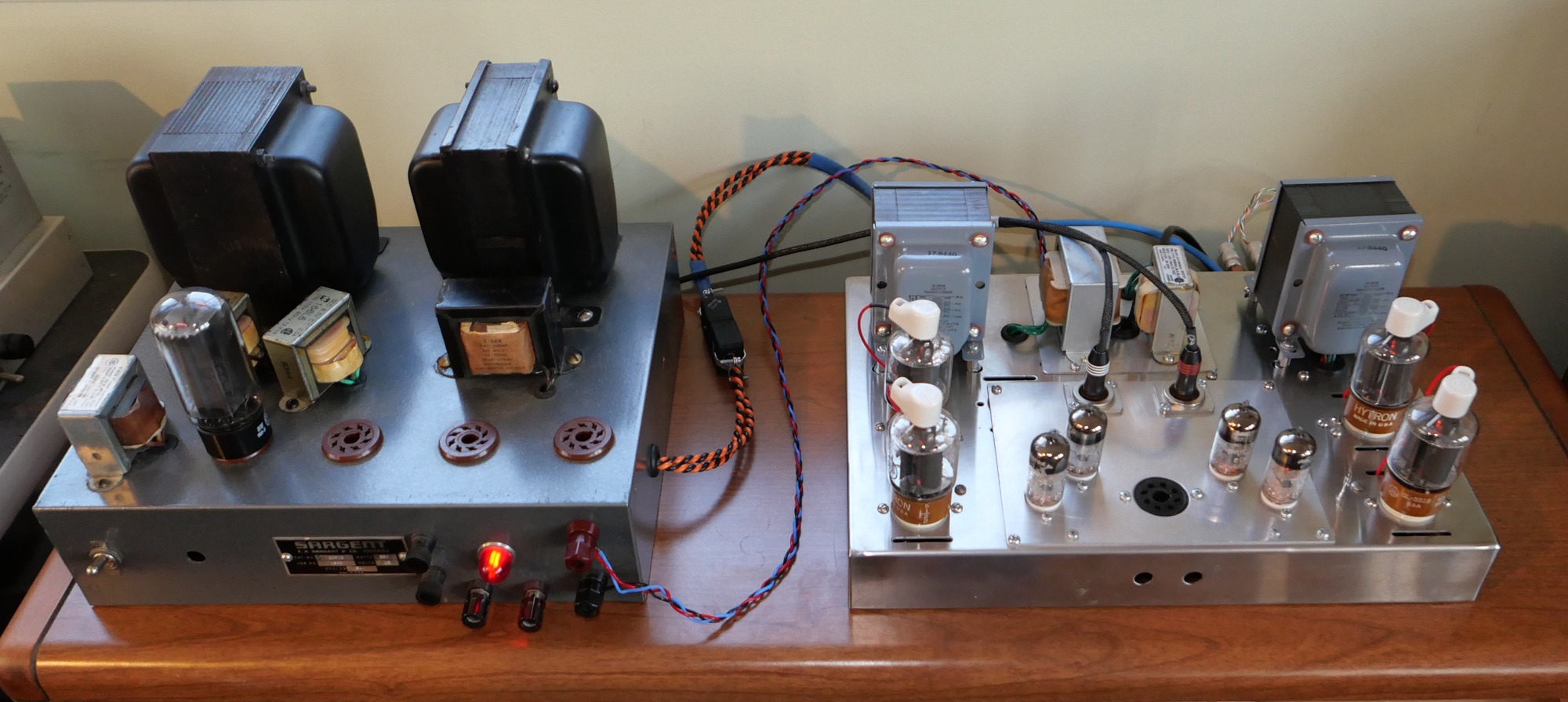

The BW specs. are impressive: 7Hz to 50kHz, but they are only rated for 50mA current per tube. I run my 5516 at 60mA and they make full power at 20Hz.
The chassis is made for Dynaco ST70 outputs so I had to mount the Triads on standoffs so the wires would not be crushed where they go through the chassis.

astouffer,
Wow! . . . What a nice find.
Those are 50% UL taps.
That is half way from Pentode or Beam Power Mode (0%); to Triode Mode (100%).
You might try one of my favorites, very well matched JJ 7591S
I drive right over to eurotubes.com, they are very completely re-tested, and very well matched.
Whatever type of output tubes you use:
Be sure to exactly match the quiescent currents (the output transformer will love you for that).
Either Adjustable Fixed Bias;
Or individual Cathode Self Bias resistors and individual bypass caps, does the job if the tubes are very well matched.
Have fun designing, building, and listening!
