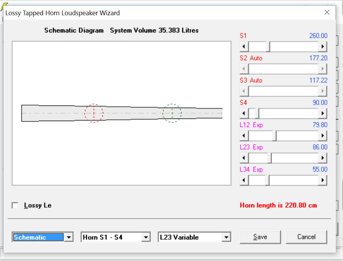

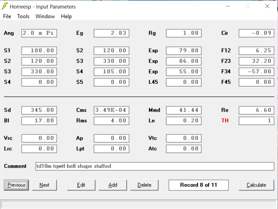

So, I finally got around to moving on with this project! ha ha!
using hornsrep, I get this......
(slightly undersized 3:1 taper)
does that look right?
I assume the red circle on the schematic page signifies the driver location? and so L12 should be 73.6?
Just to confirm, the units for s1 to s4 are CM2?
Sorry, wouldn't be my first choice; import my basic Vb = ~Vas, Fp = ~Fs TTQWT to view and/or use as a baseline, though don't recommend tuning below Fs as it's already power limited to ~50 W. It looks horrible until you view it in the Wizard with stuffing to smooth it out.
Correct.
??? L12 is normally a function of the driver's upper mass corner, so with a fairly high Fs, low Qes it's out near each end.
Correct.
GM
edit: BTW, these are tapped TQWT, but just noticed that earlier you say you want a simple TQWT, so are we wasting time here?
Correct.
Correct.
GM

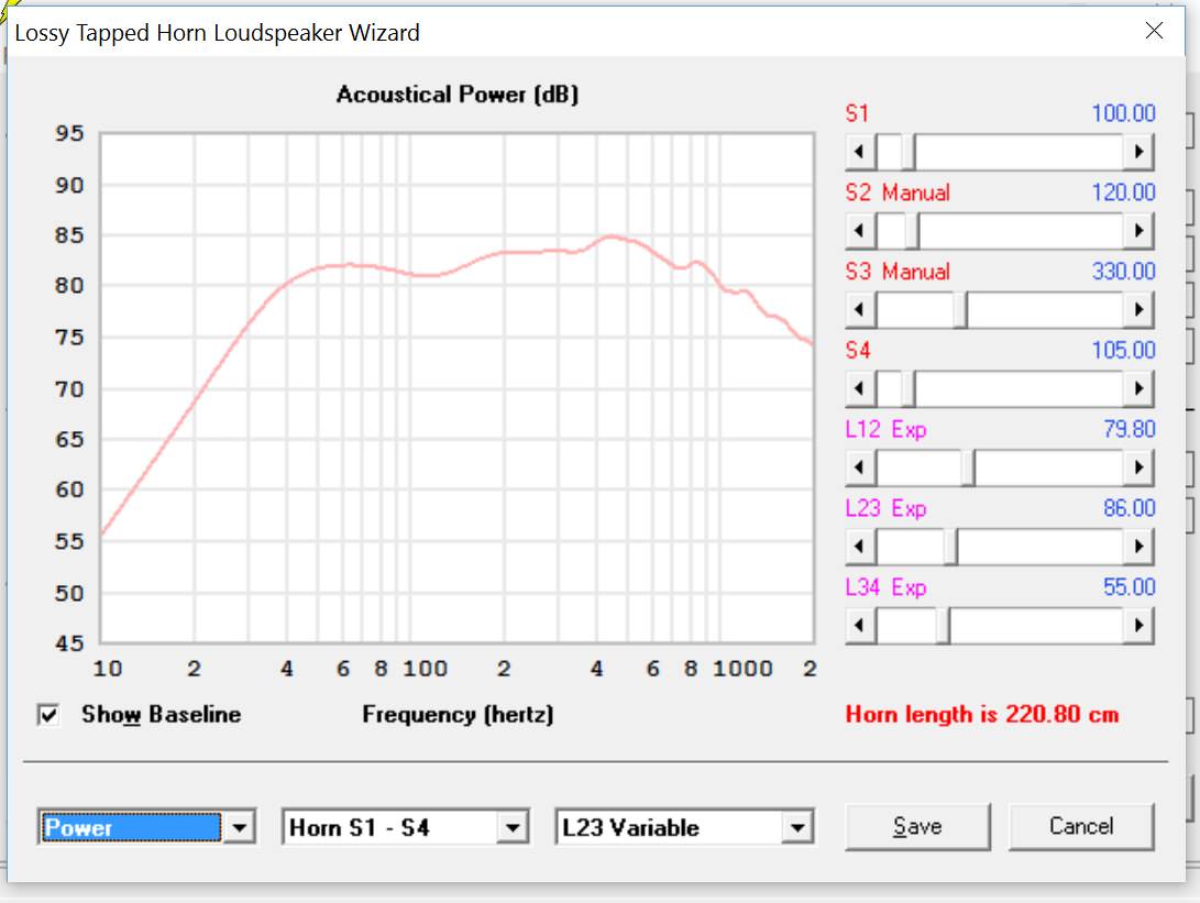

Thanks GM,
In a standard vented box, I get a f3 of about 85hz. Of course this is in a box that is only 11.5l !
Your model requires a 59L box, which is possible, but I'm looking for a cabinet that is roughly 110cm x 20cm x 30cm maximum external dimensions, giving me about 40L to play with.
This design get me to 37.5L.
The question is,
1) How accurate is Hornsrep?
2) If a satisfactory response is simulated, are there any other real world factors to be considered? I have heard:
3) Is Hornsrep only simulating the horn response or the horn and the drivers rear radiation, or is it the front as well? The response drops down as the frequency increases above 400hz in my simulations, this is obviously a problem if it includes sound output from the front.
I have heard several rules for making a horn, but I don't know how true they are?
1) That the horn length must be 1/3 of the Fs of the driver
2) The areas of each end of the horn must add up to the length of the horn (approximately)
3) The driver must tap at 1/3 of the way down the horn for a flatter response.
Basically, is this actually going to work? And is it a good idea?
In a standard vented box, I get a f3 of about 85hz. (vs 37hz for the horn) Of course this is in a box that is only 11.5l !

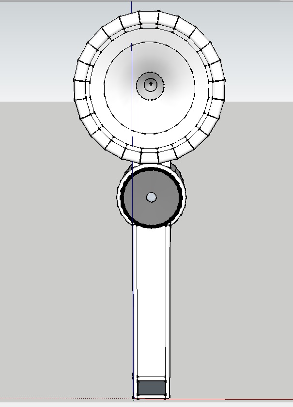

Here is a Sketchup drawing of a possible cabinet for the speaker.
Its a JMLC 350 horn, about 600mm wide. The compression driver is currently a JBL 2452, but may change for a D2 at a later point.
What do you think?
The TD10M cabinet is 1000mm tall in this drawing
When putting a fold in the horn, how do you measure the length? Do you calculate it as the shortest route, or as the average distance from one end to the other?

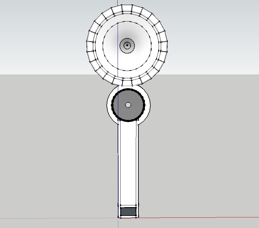

The TQWTL looks to be too small. And having a cabinet edge inside that close to the driver is a receipe for early reflection and unwanted cupped sound particularily in voices.
dave
dave
Hi Planet,
When you say the cabinet edge is too close to the driver, do you mean inside the cabinet? as in the sonotube is too close to the diameter of the driver?
externally, the speaker has a 3/4 inch round over all around the driver.
On hornsrep, my best simulation gives S1=259, and S4 = 90. I took this to mean 259cm2?
When you say the cabinet edge is too close to the driver, do you mean inside the cabinet? as in the sonotube is too close to the diameter of the driver?\
Yes the inside/ With a driver this size i'd want at least 50mm each side.
dave
Thats an extra 25mm each side. There is a compromise aesthetically here for me for going much bigger. I'm hoping that using a 3/4 inch round over bit on the inside of the baffle, and filling in the inside of cabinet where the baffle meets the sono tube in order to smooth the airflow further may help.
I know exactly what you mean about 'cupping'. This was the sound I could hear when listening to the KEF R500s on demo last week (for fun, as I had been reading about just how well that KEF co axle driver measures)
I assumed this was due to the tweeter being mounted in the mid driver.
Is it still noticeable when only playing up to 500-700 hz?
Not going bigger will ompromise the sound, and i doubt you can fit a proper TL into that box.There is a compromise aesthetically here for me for going much bigger.
Yes. Voice fundementals ar ein that range or below (male bass fundemental on the order of 80 Hz)Is it still noticeable when only playing up to 500-700 hz?
dave
