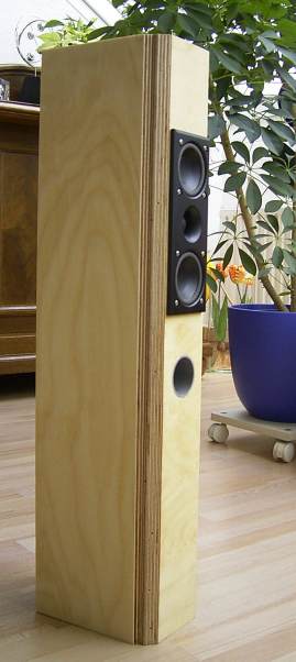

Update
Again it´s supposed to be a straight QWT, how much of that I really managed I can´t tell as I still have no measuring equipment for a fr-plot.
I simulated with Martin King´s worksheets at a average driver position of 0.4 and finally placed them at 0.2 and 0.6.
I also simulated both specific positions which looked okay in themselves.
In comparison with the former QWT I brew up with only one driver these play with MUCH more authority in the bass and very nice as well that you have two point sources now which improves "dispersion" and so give a much better stereo feel.
Lenght again is 40cm, area is 16*12*cm^2
Radius of the port is 1.6cm, lenght 1.8cm position at 35cm.
I really do like the sound of them but have the feel they have slight bump around 100Hz which I will hopefully measure soon.
A notch filter is still to come.

My gut reaction is that the lower driver would effectively kill the quarter-wave action of the tube by introducing frequencies higher than those presented by the upper driver in that portion of the tube (I hope that makes sense). That may be the cause of the lower bass response.

Ok, I'll try. In order to get bass extension from the cabinet the upper frequencies get "stacked up" in the upper portion of the cabinet while the lower frequencies "stack-up" near the port. Positioning the driver helps suppress the third-order harmonics. If you place a driver low in the cabinet you're introducing the frequencies that you don't want at the port. I think you either need to place the drivers as close together as possible on the front baffle or make the speaker a bipole with both drivers the same distance from the top of the cabinet.

I would second Timn8ter´s advice to "make the speaker a bipole with both drivers the same distance from the top of the cabinet". I can´t imagine the constellation as presented in the picture to work as a real ML-QWT. And I see strong lobing at the higher frequencies.
Correct, find the point where the 3rd harmonic is suppressed and use it as the acoustic center of however many drivers is to be used, which should be placed as close together as physically possible. Now what the pipe 'feels' is a virtual ~rectangular driver. Ditto with an MTM except the tweeter is positioned at the acoustic center, and as you surmised, pipe loading is severely compromised if it's a short line, effectively making it acoustically a BR.

Thanks everybody for the insight and critiques.
Just shows that I like to put things together before reading up enough. ;-)
Anyway had a lot of fun with them, smelled some "real wood" after a MDF-period (birch ply) and actually really do like the sound of them.
Without any notch they don´t sound as boomy as the other variant and even the sealed version whilst providing more bass.
I kind of understand that the bipole variant would be the preferred but theoretically : what would have made my attempt more succesfull?
Just moving the drivers closer together?
At least now I got another project even without thinking about it.😀 (when I´m finished listening to those)
